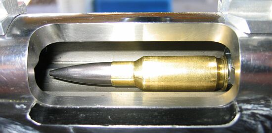

30BR Cartridge Guide
Small, Efficient 30 BR is the Dominant Score Shooting Cartridge
With Commentary by Joe Entrekin, Al Nyhus, and Randy Robinett
