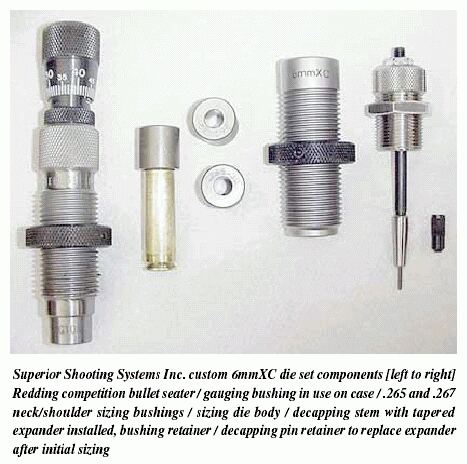

    Neck Tension and Sizing Bushings
    Two neck/shoulder sizing bushings are included with the die set. One is .265 diameter, one is .267 diameter. Depending on the make and lot of brass you’re using, there may be different neck wall thicknesses. I choose a bushing that gives me 0.003-plus case neck tension on the bullet. In other words, I measure the sized case neck inside diameter and want that to be 0.003 smaller, or slightly more, than the actual bullet diameter (0.243 inches). Due to differences in wall thickness and brass characteristics, different brands and lots of brass may size “differently” than others. The best way to proceed might be to size a few cases using each bushing and see what the end results are by measuring outside case neck diameters before and after seating a bullet into them. That is the sure way to determine case neck tension, and, therefore, which bushing to choose for routine sizing use.
    Another way to do it is measure the outside diameter of the case neck of a loaded round and subtract 0.004 from that figure (accounting for spring back in the brass); use the bushing that is closest to that figure, but err on the side of the smaller bushing. My experience has been that the only real danger is having too little neck tension to hold the bullet (less than 0.002″ difference).

    Dies for 6XC
    Superior Shooting Systems contracted to have custom sizing dies made. These are packaged in a 6XC Die Set with a Redding-made micrometer bullet seater. The sizing dies feature neck AND shoulder sizing bushings, not just the neck bushings used by Redding and most others. Our Die Set has additional features that make it work better for case-forming, such as a tapered expander. 6XC Die Sets are in stock and shipping. Prices are $61 for the seater and $119 for the resize die, and full instructions are included. A comparable resizing die from Neil Jones is $175 without any bushings.
    Tubb 6XC Die Set
    Click here to download 6XC Die Specs and Reloading Instructions as a .PDF file.
    In addition to the Superior Shooting Systems Inc. custom 6XC die sets, Redding now has its own version of 6XC dies, and they work very well. The full range of Redding dies is offered, including Competition Micrometer seater dies, and Type ‘S’ full-length bushing dies. See photo below. Forster Products also has 6XC die sets available.
    6XC Redding Reloading Dies
