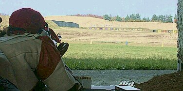

300m Bisley England UKIn Europe, 300m shooting is serious business. With iron sights, these guys are shooting 2″ groups at 330 yards! Eat your heart out David Tubb. The most common caliber in international 300m rifle competition is still the 6mm BR. It offers low recoil, exceptional accuracy, and very high-quality commercially-loaded ammo from Lapua and Norma. However, both the 6XC and 6.5×47 are coming on strong. The Norma 6XC factory ammo is superb, and the 6.5×47 Lapua factory ammo set a World record at the 2010 ISF Worlds. The photo at left is from the famed Bisley rifle range in England.

Compared to High Power matches in the USA, 300m competition is decidely high-tech. Many shooters use metal or composite-stocked rifles fitted with elaborate adjustments for buttstock length, offset, comb height, and even trigger position and angle. The precision-engineered iron sights can run up to $1000 per set.
Many of the 300m rifle ranges show a similar level of technological sophistication, using automated targets that transmit bullet impact to remote screens positioned next to the shooters. No longer do waddies have to languish in the pits pulling targets and marking hits with stickers. The targets are also wired directly to the match control center where computers plot and calculate scores instantaneously. With such “real-time” electronic scoring, 300m multi-relay matches often conclude in one-third the time of a typical NRA High Power match in the United States. Though America leads the world in rifle ownership per capita, for the most part our match scoring methods are quite primitive compared to Europe’s.
