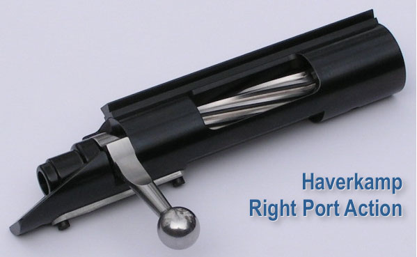

Haverkamp right port action.></p>
<p><img src=
Haverkamp Precision is a relatively new entrant into the custom action field, but Tom Haverkamp produces a very high-quality product. The LV40 action, $885.00 before options, is similar to the Remington short style, except it is .200″ longer and .060″ larger in diameter. The extra length allows a longer barrel tenon, which increases barrel support and rigidity. The Haverkamp Precision action does not use the detachable recoil lug sandwiched between the action and barrel. The tenon thread is 1 1/16” – 18 TPI. The port opening is 2.400″ long. Weight of the action with trigger hanger is 34 ounces. The receiver bottom is solid (no magazine cutout) and has a flat, milled section for added bedding support. A detachable aluminum trigger hanger allows for rapid removal of the trigger for adjusting without removing the barreled action from the stock. (Drop out trigger) uses any Remington style trigger: Jewell, Timney, Basics, etc. Standard price includes deep machined helical fluting of the bolt.
HaverKamp Rifle actions
The receiver and bolt are made from aircraft quality 4140 chrome moly steel heat treated to Rockwell 41-43C. All openings in the receiver are machined in the hardened material after heat treating to maintain straightness. Receiver thread and faces are square and concentric. The bore is honed and air gauged for a close fit with the bolt (.0015 to .002 ). Price includes polishing both bolt and receiver, There is no bead blasting on this action.
Haverkamp Actions
Stocks inletted for Remington short actions will work with a Haverkamp Precision action with some modification. The actions can be glued in or pillar bedded. Pillar bedding kits with aluminum trigger guard will be available in the near future. The bolt release is either of two types: A: Standard Pull pin style made from 4340 alloy steel; optional Push style, stylish (additional cost). To learn more, visit Haverkampactions.com.
