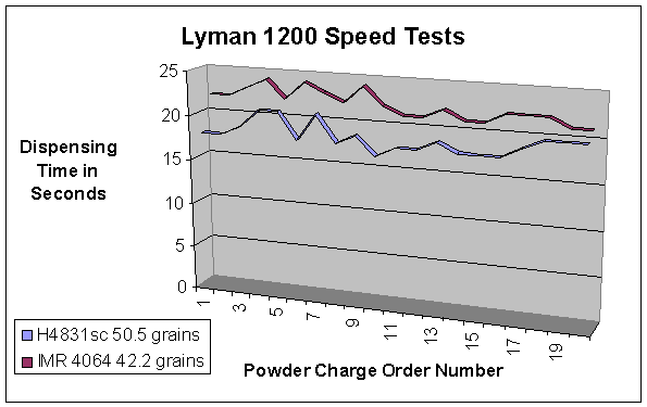

Lyman 1200 Powder Dispensing Speed Tests
We threw 20 charges with both Hodgdon H4831sc and IMR 4064, and timed the charge to completion with a stopwatch. The Lyman’s average “fill” times were 18.9 seconds for H4831sc and 22.1 seconds for IMR 4064. This means the Lyman is signficantly slower than the RCBS for both powders. The chart below records these results. The vertical axis displays time in seconds, while the horizontal axis shows the number of the test charge, 1 through 20.

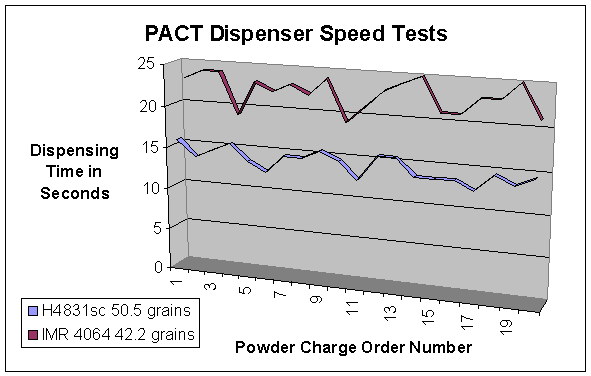

PACT Powder Dispensing Speed Tests
We threw 20 charges with both Hodgdon H4831sc and IMR 4064, and timed the charge to completion with a stopwatch. The PACT’s average “fill” times were 14.65 seconds for H4831 and 22.5 seconds for IMR 4064. This means the PACT is signficantly slower than the RCBS for both powders. The chart below records these results. The vertical axis displays time in seconds, while the horizontal axis shows the number of the test charge, 1 through 20. (NOTE: The PACT dispenser we tested has the current, “high-speed” PACT internals. The older PACT dispensers are about three times slower.)
