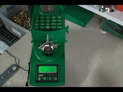

Instructional Video
The video below shows how to set up and calibrate a Chargemaster 1500. Be sure to level the unit carefully, both left to right and front to back. Starting at the 1:44 mark in the video you can see the unit dispense a 50-grain charge in 30 seconds. The slow, final trickle stage takes about half of the total time.
[youtube width=”600″ height=”400″]http://www.youtube.com/watch?v=KwGrlzrVAC8[/youtube]
