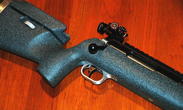

My growing High-Power addiction was pushing the limits of my .223 Match AR. The Port Malabar Rifle and Pistol Clubs’ excellent 600-yard range in Melbourne, Florida convinced me that my skill level (Sharpshooter) required a “Hammer” for a mid-range course. German Salazar’s success with his RPA Quadlite 6BRs convinced me that 6BR was the way to go.
The Project
I choose the Barnard ‘P’ action simply because it was a rock-solid action that’s proven itself time and again in international competition. The Barnard features a reliable, adjustable trigger, and a strong, triple-lugged bolt. Al and Dan Warner did the machining, fitting a 29″ stainless Kreiger barrel, with 1:8 twist and Palma contour. The Warners topped it off with their fine combo Iron-Sight, extended scope rail, and Warner-modified front RPA ladder sight.
On German’s recommendation, I ordered a prone, High-Power match stock with an Anschutz hand-stop rail, and fully-adjustable buttstock from Master Class. My stock would be something special–a true custom. Alex Sitman asked for my height, arm length, and hand measurements, so the stock could be custom-fitted. The project took about seven months to get together, but I did get the stock order “in-line” at Alex’s shop before the Warners were done with their metal work.
How It All Turned Out
The rifle displays incredible attention to detail, fit and finish. It fits my hand and arm length very well. Break-in went well and the last group of my first 50 handloads at 100 yards grouped very tightly. To my surprise, however, I didn’t like the Barnard trigger initially. It felt mushy and the sear release seemed to vary from shot to shot. I consulted my mentor again, and Salazar told me it simply needed to be adjusted. We spent a short time working with the trigger. The trigger pull is excellent now–light, crisp and clean.
Support Our
With bipod and scope, this rifle drills the X-Ring at 100 yards all day. Prone, with sling and iron sights, I know I’ll be challenged at 600 yards–but I’m looking forward to improving my marksmanship now that I have a super-accurate rig. I wanted a 6BR so I could basically forget about the hardware and concentrate on the shooting. That’s exactly what I got. When I have a chance to shoot it scoped for groups at 600 yards, I’m sure it’ll be a tack-driver. For my iron sights and slung prone, I will only be limited by my ability to see the target with old eyes, and hold the sight picture steady. My 6BR project will shoot exactly where I hold it, and I know for sure I am still the weakest part of the equation.
