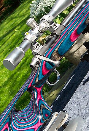

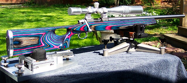

This handsome rifle is owned by Oregon’s Jason Bingham, a school-teacher by trade. Jason writes: “Here’s my old 300/600 yard competition rifle, smithed by Bob Wolcott and myself. Sad to say, this rifle is now owned by another gentleman in Oregon, but I am very proud of how this project came together. It features a short Rem 700 action that has been thoroughly prep’d for competition. The stainless barrel is a 29″ 3-groove Pac-Nor Supermatch with a 1:8″ twist, anchored in a Shehane Thumbhole Tracker stock. The gun consistently shot .300″ groups at 200 yards. My load is 105gr JLKs at 2715 fps with single-digit ES & SD.

After all of the major components had arrived it took about a week and all of the metalwork was complete. Needless to say Bob does top-notch work and it shows in his attention to detail (You have got to love engineers). Everything functioned flawlessly and the bolt/action clearance was exactly like Bob had said it would be; no movement whatsoever with the bolt closed yet loose as a goose when open. The bolt face looked like one complete insert inside of the bolt face yet in actuality it is two pieces with a very tiny firing pin hole dead center. I have heard my father many times say, “It is all in the details!”, and this rifle is a perfect example of that. The bolt shroud I had purchased for the rifle had a matte silver finish that didn’t match the finish on the BAT bolt handle. So Bob got out the handy bead blaster and blasted the surfaces until they matched as closely as possible, then he did the same for the Jewell rings and Davidson bases.
Shehane Laminated Thumbhole Tracker Stock
I call Bill Shehane, “The Man” when it comes to 1000-yard laminated stocks, and his Tracker series was the obvious stock choice for me. I’ve owned other Trackers and they always worked well. As the name suggests, these stocks ride the bags incredibly well, and I’ve found the thumbhole design to be comfortable and effective, whether shooting from the bench or prone. I had seen a combination of colors on one of Bill’s rifles that had been featured on the cover of the June 2000 issue of Precision Shooting. After a long, informative chat with Bill (how I love the famous North Carolina “Good Ol’ Boy” drawl), I had a stock on the way. It wasn’t just any color combination either–it was Bill’s brand new Blue/Wine/Dark Blue/Grey Rutland combo. Bill said it was going to knock my socks off and he couldn’t wait to see a picture of my completed rifle. The $285 Tracker arrived Priority Mail that same week, and when I got a look at it, I knew it would be a winner when we got through with it.
The Tracker series stocks come from Bill with the barrel channel, action area, and trigger assembly hole already rough inletted. My task for the night was to make the ejection port, bolt handle, and trigger safety cuts, completely sand the entire stock, and rough out a buttplate from a scrap piece of aluminum. The sanding job started with 400 grit paper and continued all the way down the scale to 1600 grit, prepping the stock for its first coat of automotive clear coat. Bob and I had an agreement, he would shoot the stock with clear coat as many times as I wanted for $40 as long as I did ALL of the wet sanding. So began the dance which saw us meeting at one of the local coffee shops to exchange stories and partially completed gun parts every other day. $40 for painting, $20 for sanding supplies, $5 for coffee, lots of funny looks from folks in the java shack–priceless. We ended up shooting five coats of clear on the stock and after the final coat we took a variable speed drill with a buffing wheel and proceeded to cover ourselves with liquid buffing compound while bringing the finish up to a very, high polish.
We assembled the last of the rifle components and the barreled action was bedded with a rough coat of Marine-Tex, sanded, and a skim coat of Acra-glas was applied. Everything was now rock-solid. I decided to mount a Weaver T-36 in the Jewell rings. I got the scope for $295 from a local shooting friend of mine and it would work nicely for the 300 and 600 yard matches. From the first phone call to order parts to the final screw on the scope rings, this rifle took only four weeks to complete. Now it was time to see what it could do.
