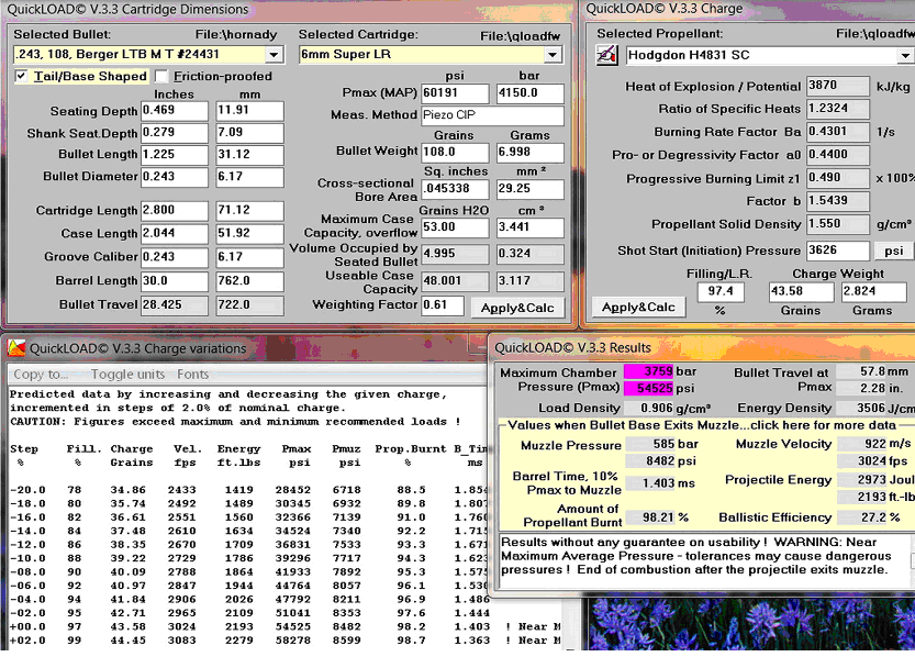

QuickLoad Projects Good Velocity with Moderate Pressure (54525 psi)
Here is my QuickLoad output for 43.59 grains of Hodgdon H4831sc with Berger 108gr Match bullets, seated OFF the lands, at a 2.800″ cartridge overall length (COAL). Note that I am using a 53.0 grain case capacity with is slightly different than the 54.0 grains Robert Whitley lists. You should measure the H20 capacity of your own cases after forming and full-length sizing. Note: The pressure and velocity numbers are only a software projection, and this chart does not guarantee that a similar load is appropriate in your gun. Many variables can affect pressure. For example, my barrel has an 0.237 land diameter. A barrel with an 0.236 land spec could show more pressure with this load. Additionally, pressure levels can change with different powder lots, different primers, and different COAL.
Super LR Quickload
