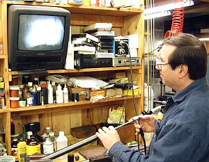

Any “short list” of American barrel-makers has to include Clay Spencer. Walk down the firing line at Hawks’ Ridge in North Carolina and you’ll see plenty of Spencers on top 1000-yard rigs. And his barrels regularly show up on the equipment list of match winners. There’s a reason. Clay is fastidious about the quality of the steel he uses and he independently tests each lot of 416 stainless steel. His pull-buttoned barrels are all hand-lapped with closely-controlled dimensions. He stands behind his barrels’ quality. It’s also nice to know that the man who builds your gun also builds the barrel so there are no excuses when the finished gun is completed. HV and LV 26″ BR contours run $275.00 and up. Sporter contours are $25.00 more, while Unlimited (1.350″ to 1.450″) barrels start at $300.00, with a $20 surcharge for 30″ finished lengths.
