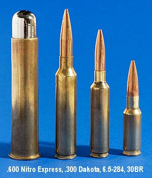

While I had previous experience with the 6.5-284 cartridge, the new 6.5 barrel had been sitting at Gre-Tan for over four years before it was chambered. (Bob Crone had suggested purchasing this barrel when Krieger had made a particularly excellent run of these fine 8.5 twist tubes.) Well it turns out it was worth waiting for that barrel. It shoots superbly. My best load currently is 50.8 grains of RL22, Federal match primers and Sierra 142 MKs seated 0.020″ short of the lands.” [EDITOR’S NOTE: this load works in Gene’s rifle, but it may be too warm for you gun. Always start 10% low and work up. Seating Depth changes–going into the lands, for example–can also alter pressure significantly.]
Caliber Choice–Why the 30BR and 6.5-284
Gene explains: “I decided to go with a 30BR after consulting with Randy Robinett of BIB Bullets. Offering to help get ‘this project on the road’, Randy sent his reamer to Greg Tannel and rounded up a barrel from a large order placed with Pac-Nor. Early articles in Precision Shooting had left no doubt in my mind that a 30BR should be capable of superior, consistent accuracy and it should not be temperamental to tune. The major challenge with the 30BR is finding a better load than the one you are using already, since it’s so easy to tune! This is a very shooter-friendly, exceptionally accurate cartridge.
For my long-range barrel, I chose the 6.5-284 because it’s becoming the most popular 1,000-yard cartridge and so much is known about its design and capabilities. Good loads are well-known. This case and the 142 grain Sierra BTHP is a tremendous combination, particularly if you sort the bullets for consistency.

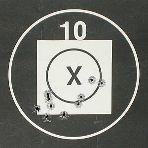

Gunsmith Rick Beginski notes that Gene wasn’t the only one to shine at Upper Nisqually this past June. Rick tells us: “Here is the pic of Gene’s 30BR record-setting target. It looks like he has two records, score 100-5X and a group of 2.287″. On the same relay Billy Copelin shot a 2.9xx with a 100-4X. Billy also broke the Light Gun Six-Target Agg but Ron Baker (shooting a 6.5-284 with 142 SMKs) grabbed that record from Billy with a smaller Agg. Billy did wind up in the record books for a Two-gun, Twelve-Target Agg and a Heavy Gun Six-Target Agg. Billy and his 6.5-284 with 142 Sierras broke five records in the course of the match, but he only got to go home with two. It was a good weekend for the Washington State 600-yard Championship. All these results are in the recent NBRSA News, subject to final approval.”
Gene reports: “[My records] were a combination of circumstances. I had received a different Light Gun from a gunsmith at the range and still wished to shoot my 13-lb 30BR, so I had no choice but to enter it in the Heavy Class (70-lb weight limit). There was some good-natured ribbing, but things turned quiet when I discovered I was in third place on the second day. After the first match, the wind was low and constant at about 15 degrees from left to right, towards me, from the target. This direction made it simple keeping track of the wind on a wind flag I could see easily with my left eye. I started to shoot at the signal and made sure the rifle returned to battery consistently. The conditions did not deviate and I made no adjustments at all during the string to the rifles’ position on the bags. Match Director Rick Beginski came out and said that Billy Copelin had tied a ‘X’ record with a four-X group and then he announced I had broken both ends of the World Records in the heavy class with the 30BR. The group was 2.287″ and all were in the white sighting square with five in the X-Ring, breaking the Score Record. It felt like a good group, but I was still shocked. And, please, let’s not talk about the size of that last group I shot that day–I lost third place by one-half thousandth of an inch.”

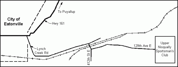

The Upper Nisqually Sportsmen’s Club (UNSC) range, nestled in Washington’s Cascade Mountains, is one of the most beautiful ranges in the world. With Mt. Rainier as a backdrop, matches are held all year round. At Upper Nisqually you don’t have to worry about gale force winds, extreme summer heat, or terrible winter blizzards. It’s truly a wonderful place to shoot for those who love the challenges of long-range competition. Built with true determination and dedication by Ron Baker and his helpers, UNSC’s 600-yard range is so new that the roof over the ten benches hasn’t even been built yet! Matches started in February and three NBRSA World records have been set and five others are pending in just this short time! While I feel honored to have shot two pending World Records at Upper Nisqually, I want to give credit to the others who broke records as well. Both the heavy and light gun agg records were set at the same meet. Billy Copelin set the heavy gun agg records of 3.670″ (60 shots) and 3.284 (120 shots). Ron Baker set the light gun agg record of 3.276″ (30 shots) at this meet. These two, along with Rick Beginski, form the nucleus of the outstanding shooters from this area.
If you’re ever in this area, come visit–there are camping and lodging facilities nearby. Matches are regularly scheduled, and Rick Beginski, (425-349-5043) or Kevin Watson (253-847-1616) can provide match info. The UNSC website has directions to nearby Eatonville, WA, and to the range. Upper Nisqually’s reputation is growing as word of their “Ironman” BR competition spreads, a two-day shoot featuring ten-shot matches at BOTH 600 and 1,000 yards on each day.
