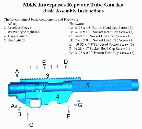

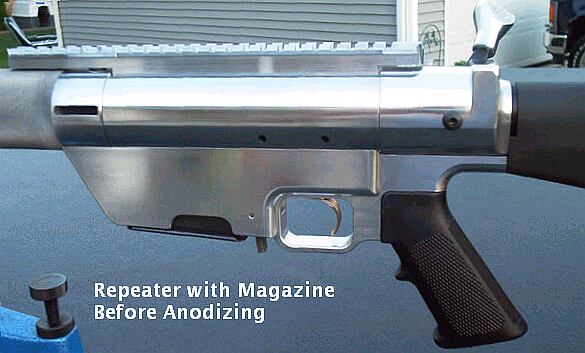

Component Description–What Goes into a MAK Tubegun
Kevin told us: “My repeater is a standard short-action Remington 700 that had all of the work done to it (threads recut, action trued and lugs lapped, etc.) Gary Growe performs this locally using Greg Tannel jigs and fixtures as well as his own. We chose not to sleeve the bolt as it was to be a repeater. I have several barrels for this rifle but the two that I use most are a 6BR and a .243. Both are cut-rifled barrels from Steve Satern in 1:745″ twist. We use a Pacific Precision 6BR reamer with a 0.273″ neck. Both barrels are medium Palma tapers finished at 28″, as much length as I thought I could handle in a repeater. Mike shoots a 30″ barrel on his repeater but he is 6’8″ tall! I use a Jewell trigger, no safety. There are a few of our kits set up for the tactical market. These employ a Jewell bottom safety because the standard Remington will not fit. We could have made this work but it would have required a scallop in the sleeve so we chose to leave this detail out. For across the course shooting, I use what I would call the standard or the Warner rear sight and a basic ladder front sight. Both front and rear sights have adjustable apertures and I use a 0.3 magnification lens in the front. When running a scope, I use a Leupold 8.5-25×50 Long Range Target model.”

Q: Tubeguns really stand apart from most other rifle designs in offering extreme accuracy in a package that a home smith can work on. Is the kit aspect a key part of the tubegun’s success story?
A: A kit lowers the cost of entry substantially compared to an out-of-the box rifle. And with the kit concept, I think that most shooters would agree that there is always more satisfaction if you can win with a rifle that you had a significant role in building.

A: There are several advantages. For one there isn’t any bedding to contend with. The barrel is free floated. For those who shoot an AR15, it is almost identical. The only change that was made was to move the trigger slightly forward in relation to the back of the pistol grip. Most any AR15 butt stock or pistol grip can be used. Barrels can be changed easily. The hand guard is held in place by four screws which can be removed quickly to expose the barrel. Since the action is enclosed the bolt can be cycled without having to change your head position on the stock. And with the action glued into the sleeve it becomes one unit. The gluing process is relatively simple. It takes about an hour to accomplish with a package of JB Weld, a bowl of water, and some Q-Tips to dip into the water to clean up any excess bonding material.

A: Start with the basics. You can easily source standard AR15 components to complete the rifle. We recommend truing-up the action before gluing. A standard barreled action can be installed as received from the factory with the lug trimmed if you’re on a tight budget. The action can be removed from the sleeve if so desired but it is best to do it right the first time to avoid this.

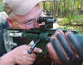

Tube guns are fun to shoot, and that enjoyment isn’t limited to the “Good Ol’ Boys.” Sue Mogle is a very successful High Power prone and position shooter, and she’s won many honors with her candy-apple red MAK Tubegun. Sue reports: “Those tube guns feature prominently in the top places at most of our long range matches. They’re easy rifles to shoot well. And they’re extremely cost-effective! It’s probably the cheapest way to build a truly competitive rifle for long range.”
Sue explained: “The tube gun is a sleeved action, it keeps the recoil in a straight line and requires no bedding, which can break down. Maintenance is very low! Most of us shoot prone slowfire (NRA High Power long range), but several of the guys have shot F-Class also. I’ve never benched mine, so as far as what accuracy the rifle is actually capable of I’m not sure, but for NRA High Power you need a minimum of a minute-of-angle rifle. The tube gun will easily do that. Mine is chambered in 6.5-284. My personal best at 1000 yards is 198-12, every shot dead on call, including the two 9’s due to loose-nut-behind-the-trigger. I’ve shot a couple of other conventional rifles, 300 WM with a McMillan prone stock and a 7-08 with a modified 40X stock. Of the two I definitely prefer the McMillan stock. Stock fit is very important with the conventional rifle, at least for position shooting.
A lot of shooters, myself included, came to Long Range from NRA across the course High Power, and most of us shoot the AR-15 in one of it’s many incarnations. So the tube gun, modeled on the AR, is very familiar to us. With match modifications (adjustable buttstock and handstop) it’s easily configured for most shooters. I REALLY like the 6.5-284 caliber. The ballistics are similar to the .300 WM with about a third of the recoil. I’m not particularly recoil-sensitive but a heavier-recoiling rifle will knock you out of position more, and more quickly, than a lighter-recoiling rifle, requiring you to readjust your position frequently.

Editor’s Note: The single-shot MAK tubegun kit costs $525.00 in “basic black”, and slightly more for left-hand models. With color anodizing, the single-shot costs $565.00. The slick, new repeater model is $700.00 in black or $755.00 in your choice of colors. Add to this the price of a barrel ($300-$400), chambering and barrel-fitting ($150-$250), Remington 700 action (about $400), and miscellaneous components such as trigger group, handstop, and buttstock ($200). That totals about $1700-$1800 for a single-shot system (less sights or scope), assuming you install the action yourself. That’s thousands less than a complete Tubb 2000 Competition Model. If you have a spare Rem donor action, you’re way ahead price-wise.
