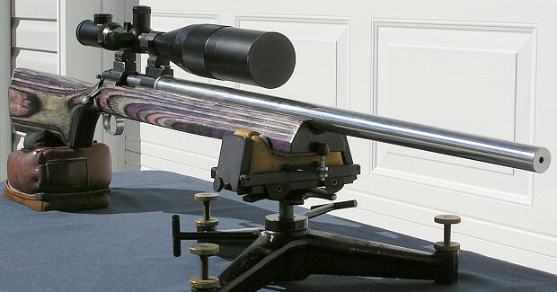

A while back James Phillips set out to build a rifle for the Annual Hickory, NC Ground Hog Shoot. Working with Mike Bryant, he ended up with a rifle that was more than just a first-rate varmint-slayer. His Bryant-smithed 22 Dasher turned out to be one of the most accurate rifles ever made. Competing in registered IBS 600-yard matches in the fall of 2004, James set three IBS world records with the gun, earning top marks for both Score (55-5X) and Group (1.174″). Veteran long-range shooters tell us that a gun that can group in 1.25″ at 300 yards should be competitive. Well, James beat that–at double the distance. James’ amazing 1.174″ 600-yard group works out to 0.19 MOA. To do that at more than one-third of a mile is a major achievement. In our interview with James, he explains many of his shooting and reloading secrets–techniques that have “raised the bar” in the long-range accuracy game.

James’ rifle features a blue-printed Remington 40X action in a pillar-bedded Shehane ST1000 Tracker stock in Rutland Laminate.
The action was trued by Mike Bryant, who also bushed the firing pin, did the stock work, and chambered the 28″ Hart 1000-yard contour 8-twist barrel.
Mike told us this was one of the best 40X actions he’s seen–its dimensional consistency rivaled the best custom actions. James uses a 12-42X NightForce Benchrest scope, mounted in 30mm Kelby rings on high-rise scope bases with 20 MOA built-in elevation. The trigger is a Jewell HVR with safety.
