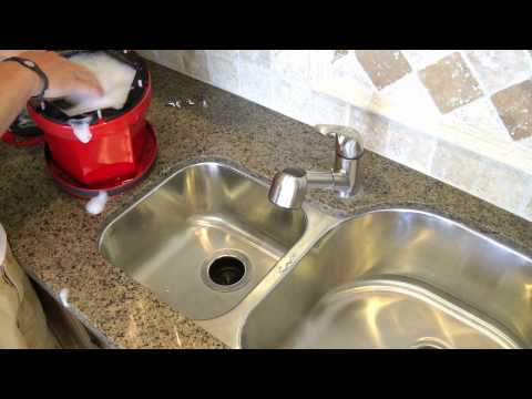

1. Setting up the Thumler’s Tumbler takes about 10 minutes. It comes mostly assembled, so no engineering skills are required, but you should read the instructions. There isn’t a lot to do, but there are a few important set-up details you shouldn’t overlook.
Lemi-Shine Brass Cleaning2. Pour the media in the tumbler, add brass, add 1 gallon of water, a small amount of liquid soap and a little bit of Lemi-Shine. Watch Cory’s video below for the amounts of soap and Lemi-Shine.
Do you have to use Lemi-Shine? Cory says: “Not necessarily. Lemi-Shine is the key to get your brass shiny. If you don’t care too much about the shine, then no. It can also help soften the water, which allows the soap to work a little better.”
How much brass should you add? Cory suggests putting about two pounds of brass in the Thumbler’s Tumbler, which has a 15-lb overall capacity (including water). Here is how that works out for different cartridge types (small to large).
stainless media
3. Shut the lid tight and start tumbling. Cory recommends one to four hours of continuous tumbling depending on the condition of the brass. After you’ve done a few batches you can figure out how long it will take for your brass.
4. After tumbling the brass, drain as much of the used, dirty water as possible out of the drum without losing any brass or pins.
Cartridge Brass Separator
5. Next, separate the brass from the steel media, and then rinse off the brass with warm water. (The rinsing stage is important to avoid spots on your now shiny brass).
6. As the final stage, dump the brass on a towel and let it dry. How-To Video:
[youtube width=”600″ height=”360″][/youtube]
SAFETY TIP: For safety sake, always carefully inspect your brass after tumbling to ensure there are no left-over stainless pins inside any cases. Normally all the pins will drop right out, but in the very rare instance, a pin can wedge in a small-caliber rifle cartridge neck. If that happens just take a small dowel (a chopstick works well), and dislodge the pin.
