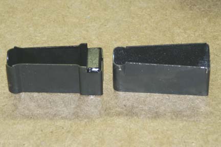

| On the left, is a Remington 700 .223 magazine. On the right, is a Remington 700 |
| The rear of the .308 magazine has been cut with a Dremel cut off wheel to make ears similar to those used on a .223 magazine to hold the magazine block (the metal spacer at the rear of the mag, visible in top photo). |

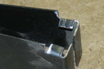

| Here is a photo of the .308 magazine with the ears bent over. | ![]() |

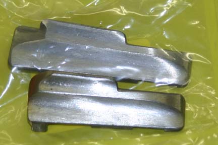

| This shows the .308 magazine with the block from the .223 magazine in place. | ![]() |
