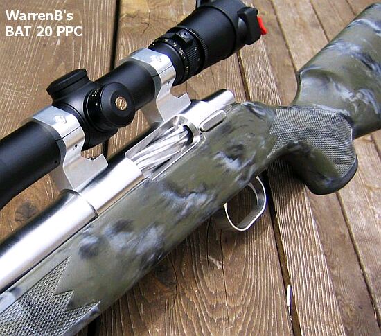

20 PPC
The 20 PPC is the smaller brother of the 22 PPC and the 6mm PPC. All three PPC cartridges are based on the 220 Russian case. Initially, the 20 PPC was used mostly by varmint shooters looking for a high-speed, flat-shooting cartridge with exceptional accuracy. But the 20 PPC is finding a place among Benchrest Competition shooters, now that match-grade 20-Caliber bullets are becoming readily available. Running a 50gr Berger (.296 BC) at 3800 fps, the 20 PPC actually shows less wind drift than a 6mm PPC shooting 68-grainers at 3250 fps. 20 PPC shooters feels this gives them an edge in windy or rapidly switching conditions.
The 20 PPC is formed by using a 22 PPC die with a 20-Caliber bushing. Bushing size depends on your neck diameter and whether you have turned necks. For varmint shooting, neck turning is not worth the effort. Any accuracy advantage is negligible. But among competitive benchresters using the 20 PPC, most believe that a tight-necked chamber with turned necks will give you a slight edge. Once the brass has been necked down from .224 to .204, you’ll need to fire-form it. There are various fire-forming strategies covered in our 6PPC Cartridge Guide. The simplest method is to use a full 220 Russian load from your powder-maker’s data sheet, seat a bullet into the lands, and shoot. You may be surprised at the accuracy that can be achieved during fire-forming. Bob Smith reports excellent accuracy (.2 MOA or better) when fire-forming with his Lilja-barreled 20 PPC. And John (SnakeEye) of VarmintsForFun.com tells us: “These 20s are a pleasure to shoot and load for. I am really pleased with the 40gr V-Max as it flat shoots very well out to 600 yards in my 20 PPC. Hornady did a fine job designing that bullet. What has amazed me is how well the 40-grainer shoots in my fast-twist barrel (Lilja 1:9″) in the BAT Rifle. I use naked bullets and can shoot 30 to 40 rounds before I need to clean and there’s hardly any fouling. There’s practically no recoil and there is a noticeably reduced muzzle blast.”

32 Hornady
V-Max
H322 27.6 Rem 7? Lapua 4000 Lilja 1:12 WarrenB Form Load
32 Hornady
V-Max
H4198 25.1 CCI BR4 Lapua 4222 PacNor 1:12 A. Boyechko Load
39 Sierra
BlitzKing
H322 26.0 Rem 7? Lapua 3700 Lilja 1:12 WarrenB Load
