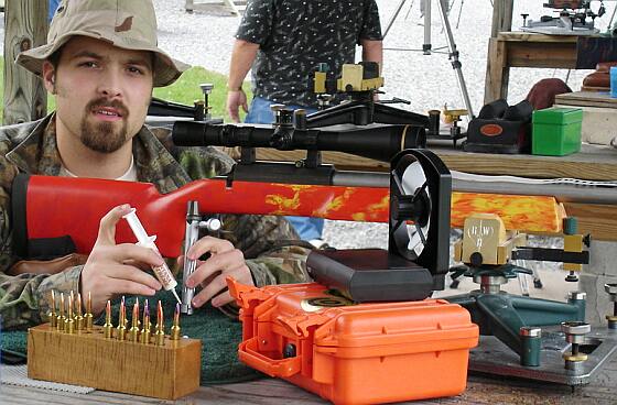

Editor’s Note: Mr. “Keep it Simple” at the Bench with his 6.5-284 Viper. Hey Jason, what’s all that clutter?
