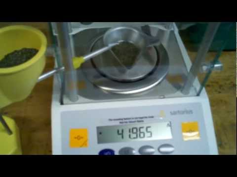

Do the advanced force restoration scales perform as advertised? Can they reliably recognize a single kernel of powder quickly enough to make trickling practical? Well, thanks to Forum member A.J. (aka AJ), we have a video that answers those questions. Using a Sartorius GD503 Class II force restoration balance with an Omega two-speed powder trickler, A.J. demonstrates how he can weigh charges that are consistent within a single kernel’s weight, i.e. 20-25 thousandths of a grain.
When you watch the video, note how (at 3:45 time mark) the RCBS electronic scale reads 41.7 grains, when in fact the correct charge weight was 41.830 grains, as measured by the GB503. That’s a one-tenth grain (four kernel) error right there. You will also see that the Omega Trickler from Dandy Products really can drop one kernel at a time. It takes some careful adjusting of the drop tube to achieve this sensitivity, but the Omega really is up to the task.
[youtube width=”600″ height=”366″][/youtube]
A.J. recently acquired his Sartorius GD503 digital scale from Retail price is $899.99. A.J. reports: “I have to say the [GD503] is one awesome unit. I was loading my 260 with 42 grains of H4350. The GD503 is accurate to .005 (5 thousandths) of a grain. My Acculab was supposed to be accurate to .020 of a grain but couldn’t do that on a good day. This new scale can actually weigh an individual kernel of H4350, it weighs right at .025 per kernel. I weighed a small screw about 20 times throughout one day and every time I got the same exact reading. My load for my 260 now has a SD in the single digits and an ES of 10 fps is not uncommon for 5-shot groups.”
Having seen an actual reduction in his velocity ES and SD, A.J. is sold on his $900.00 GD503: “This thing is amazingly accurate. It repeats every time. The weight does not keep changing or growing like my Acculab VIC 123 or my RCBS Chargemaster. My loads have never been so accurate. Now I don’t have to wait for a Prometheus as I have something better for a fraction of the cost.”

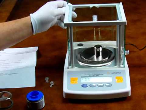

If you’re interested in the Sartorius GD503, below is a video from that explains the features of the GD503 and shows how to set up and operate the unit to achieve the best results.
[youtube width=”600″ height=”480″][/youtube]
