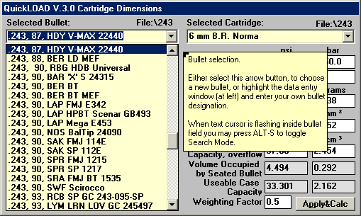

How to Create Cartridge Sets
QuickLOAD has its own extensive database of cartridges. The latest version includes the 6BRX, the 6mm Dasher, and David Tubb’s 6XC. If you like, you can just leave the Cartridge Selector so that it accesses the default “all-cartridge” file every time. However, we’ve found this becomes cumbersome very quickly. If you’re not shooting .338 Lapua Mags and .500 Nitros, there’s no need to have those cartridges in your pull-down menu. What you can do is create a custom cartridge file. You can call it “6mm File” for example, and tell the program to include all cartridges ± .0016 of a .243 bullet diameter. We did this to create a 6mm file. We also have a .223 File and a .264 (6.5mm) File. It takes only a matter of seconds to build these files. In our 6mm file there are about 45 cartridges. This is much easier to work with than a pull-down list with hundreds of cartridges, including many you’ve never heard of.
How to Create Caliber-Specific Bullet Sets
Once you’ve created your own cartridge sets, you’ll want to create bullet sets. The procedure is similar to building a cartridge set–you tell QuickLOAD to create a new bullet file containing all bullets with the same diameter. We strongly recommend creating custom bullet sets because this will augment QuickLOAD’s default bullet list with many other projectiles found in the four dozen Manufacturer’s data files included with the program. When you tell QuickLOAD to create a new .243 Bullet file, it automatically “gobbles up” ALL the bullet-makers’ data files and combines those with its own default bullet data list. The end result is that you get a caliber-specific list of projectiles that is much more complete than QuickLOAD’s default bullet database for that particular caliber. For example, once we built our custom .243 bullet file, we found we had access to a number of additional bullet descriptions, including the DTAC 115 and some Bergers, that were not displayed previously. Among the 6mm bullets, you won’t find many of the custom brands, but you will find nearly all products of the major manufacturers both in Europe and the United States.

2. Weighting Factor: QuickLOAD has a user-adjustable “weighting factor” for all cartridges. It defaults to a value of 0.5 for all “bottleneck cases”. We noted that the 6mm Dasher cartridge data uses a weighting factor of 0.4, the default value for “overbore cartridges.” As an experiment we changed the weighting factor for the 6BR to 0.45. This seemed to produce more accurate velocity results.
3. Case Capacity: The default H20 capacity for the 6BR case is 37.80 grains. However, when we measured our fired and full-length sized cases, the H20 capacity was 38.40 grains. This makes a HUGE difference in reported pressures. For initial fire-forming loads, use the 37.80 default figure. After that, measure the ACTUAL volume of your cases as they are actually loaded. Thus, measure the fired case (with fired primer) if you neck-size only. If you full-length size, then size a fired case (leaving the primer in place) and measure its capacity.
