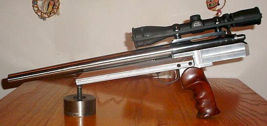

6mmBR.com’s first featured pistol is a beautifully crafted XP 100. Proud owner/builder Cayle Davis reports: “Thought you might like to see my latest project here at C & J Machine–my personal XP 100. It’s chambered in 22 BR (.250″ neck), with a 16” Shilen barrel riding in an aluminum stock I designed and fabricated. The XP 100 is a tack-driver. It groups in the high 2s to low 3s, sometimes dipping into the low 2s. I love the metal stock–it definitely adds to the gun’s accuracy. Weight, all-up, is 12 lbs with a Burris 3-12x scope. My load is 31.5gr of Vihtavuori N135, with a 52gr Barts bullet, Rem 7 1/2 BR primer, in Lapua brass. The XP 100 is sitting on our C & J Convertible Rest, designed for both rifles and pistols.

A New Stock–Why Not Aluminum?
Now that we had a good, stable, fully-adjustable rest, we started wondering about just how well that 22br would shoot. Started checking with the stock makers for a bench stock but no luck. There’s got to be something better than the HS stock, but if there is I’m not aware of it. Well my buddy says “heck, just make a stock”. We sourced some walnut but couldn’t figure out the right grip design. I also really wanted something heavier than wood. I ask my friend “how about aluminum?” “Huh?” he replied. Well, after his initial skepticism, we agreed to give it a try.
How Does She Shoot? Like a Dream!
So far this has worked out very well. The flat forearm rides the front bag nicely. We did add a V-shaped piece of walnut to the bottom of the grip to slide through the special rabbit ear bags we had made. With that addition, the gun is very stable and tracks really well for a pistol. Groups are averaging in the high 2’s and low 3’s with one group I shot last Sunday that went .216″. WOW is all I can say.
