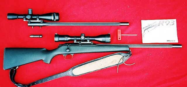

Blaser, a German manufacturer of fine rifles, combination guns and one bolt-action pistol, has 6mmBR Norma versions of the R93 Long Range Sporter (LRS) and the R93 Jagdmatch or Match Standard, in 6mm BR Norma. It can be purchased as either a version of the Safari Synthetic, the LRS or in the various wood stocked versions. The photo at right shows the deluxe engraved “Royal” edition. The Safari forearm with the larger barrel channel is all that is necessary to handle the R93 LRS 24.7” fluted barrel. The Safari Synthetic version with both .223 Remington and 6mm BR Norma LRS barrels is what I have recently acquired. View all the options on the Blaser web site.

My .223 barrel is fitted with the Blaser saddle mount and a 6x42mm Leupold Target scope. The 6BR also uses the Blaser saddle mount and it wears a Zeiss Conquest 3.5-10x scope. It is a three-minute, two Allen bolt operation to switch barrels and internal magazines from one caliber to another. The bolt face can be changed from the Medium (308 family) to the Mini (223 family) in less than two minutes without tools. I personally carry two complete bolt assemblies in the field for enhanced reliability. Should a firing pin break, I can still switch the bolt heads and shoot both calibers.

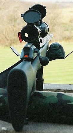

With the scopes I am using, both Safari Synthetic stocked versions weigh within a few ounces of eleven pounds, perfect for a walking around or bench shooting in prairie dog towns. All Blaser rifles share a unique trigger mechanism, providing for a consistent 2.2lb crisp trigger pull. The safety, on the back of the bolt assembly, cocks and un-cocks the rifle, making it perfectly safe to carry the gun loaded and allowing for un-cocking during long term storage without dry firing or utilizing snap caps.
