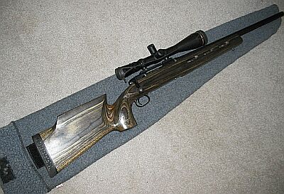

Once you ready your guns for storage, we recommend putting them in Bore-Store bags. These gray, synthetic fleece bags protect your guns against dings and scratches, and the breathable fabric wicks away moisture. The fabric is also coated with pure silicon and an extra rust-inhibiting chemical. BoreStores are relatively inexpensive and last forever. Unlike cotton, wool, leather or canvas bags, the fibers do not absorb and retain moisture. You really can’t beat them for storage in a safe because they cushion the gun as well as fight rust and aluminum corrosion. Use these with Eezox, a product that sets up a “dry” barrier, and you get superior long-term rust protection without heavy greases or oils. We’ve also found that Eezox seems to offer a “harder” and more stable barrier to fingerprints than the more conventional oil-based preservatives.
