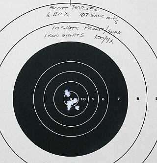

6BR Improved cartridges aren’t just for Benchrest rigs. Scott Parker has put together a 6BRX that is one of the most accurate prone rifles we’ve ever seen. After hearing some amazing accuracy reports from Scott we joined him at Bakersfield’s “5 Dogs” range for a range session. Watching Scott shoot his wondergun with sling and irons, this editor came away impressed beyond belief by the BRX. Through a spotting scope I saw him string a dozen Xs in sequence at 200 yards. At one point he popped his spotter golf tee 4 times in a row. When we pulled the target, we measured that 4-shot cluster at about 0.3″ (0.15 MOA) center to center. And he did all that with iron sights and sling–no scope or rest! In Scott’s hands, this wicked 6BRX redefines prone precision.

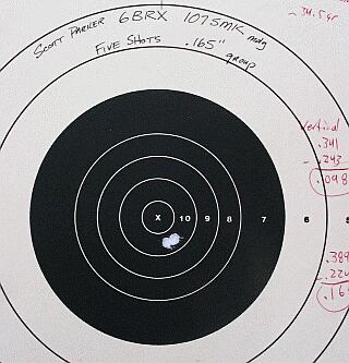

| Left Target is 5 shots at 100 yards, from benchrest with 30x scope, and rear sandbag. | Right Target is 10 shots at 100 yards, fired prone with iron sights, sling support only. |

And a Palma-style rifle works fine from the bench — just bolt a wide metal plate to the forearm and attach a bag-riding fixture beneath the butt-stock. This allows you to test loads using a quality rest and bag just like the BR guys do. (And it works–check out my 0.165″ group, shot from the bench with a 30x scope.) When your bench-work confirms a competitive load (10 shots under .5 MOA), THEN go ahead and shoot that load prone, not before. Otherwise you’re testing your sling skills, not your load’s true accuracy potential.
