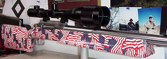

Joel’s 600-yard BAT/Leonard gun (with weight removed) and a 20.5″ 6PPC barrel served as Joel’s LV Super Shoot rig.

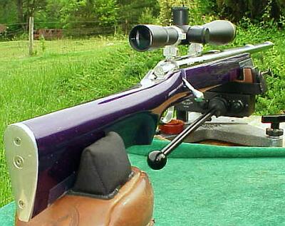

Joel notched one IBS world record with the purple Borden, and three with his Leonard-stocked BAT. Both guns are chambered in the 6×44 wildcat. Notably, all of Joel’s records were Aggs or combined LG/HG scores, not just one “lucky group.”

Joel’s world-record rifles were not purpose-built for 600-yard competition. In fact they both started out as “point-blank” BR Rigs: “I purchased my first custom benchrest rifle in 2001. It was a second-hand 6PPC Light Varmint smithed by Jim Borden, with a TPE action bedded in purple Rimrock stock. I used this gun for IBS Score and NBRSA Group shooting in the Southeast until the summer of 2002. At that time, I built my second 6PPC LV benchrest rifle with a microport BAT action, a beautiful Terry Leonard stock, and a Kreiger chambered by David Tooley. Late in the summer of 2003, I learned about the new 600-yard IBS discipline and found out that Piedmont Gun Club would shoot this yardage starting in February 2004. I decided in August of 2003 to order a new 27″ Krieger and have Dave Tooley chamber it in 6×44, a wildcat that had worked really well for Bobby Greenway. Since the Borden action already had a 308 bolt-face it was the logical choice to use for my 600-yard rifle. But I did order a new .308 bolt for the BAT action so it could run the 6×44 also.
I used the Borden for all my 2004 IBS 600-yard matches except the last match of the year in St Louis. There I used the BAT-actioned gun because it had an ejector and I could shoot a little bit faster. It turned out to be a very good choice as I set three 600-yard world records at that match. Whether it was the gun, or good conditions, or great luck, I can’t say. But I did use new brass for the St. Louis match, so that probably helped. The conditions were decent too. It was blowing 10-12 mph, but it was very steady–no problem getting off a 5-shot string.
| Borden Rifle Specs Chambering: 6×44 mm Components: Borden TPE action, Rimrock stock, Kelbly bases and rings, Leupold 40X Comp scope, Jewell trigger. Tooley-smithed 27″ Krieger 4-groove, 8.5-twist, HV contour. Added weight in butt of stock to give better balance; weight 13.5 lbs. Joel notes: “The low-profile Leonard stock may track a bit better, but the Purple Borden racked up the lion’s share of the points that won me the Shooter of the Year Title.” |

Bobby Greenway had been using a 6×44 for the last few years with great success and he helped me with starting loads for this cartridge. I used H4350 starting with 36 grains and tuned at 100 yards, settling on 37.0-37.2gr of H4350. This is with 105gr Berger bullet into the lands around .035″ with light to medium neck tension letting the bullet seat itself. I figure the bullets are ending up about .025″ into the lands this way, or .010″ “off jam”. I tried several other bullets but the Berger 105s gave the best results, and they proved very consistent both in weight and base-to-ogive length.
The 6×44 is a very efficient cartridge and not very finicky. It is easy to keep in tune–I pretty much used the same load all year from 28° to 95° with no problems. The only load-related problem that I had all last year was when I over-annealed my brass leaving very soft necks that would not hold the bullets to the same OAL length when chambered. The result was that vertical was terrible along with my match results. Consistent neck tension and bullet seating depth are obviously critical to accuracy.
The Kriegers have been amazing. From the very first shot I’ve never seen any copper. They’re just that good. I do use one trick during break-in–I make sure the lead-in angle area is smooth with no burrs or nicks. I polish that area with JB and then inspect with the bore scope before the first shoot. I can say that the Manson Reamer cut a very nice chamber in my rifles. One more word about barrels–most people worry about copper when they should be worring about carbon. I’ve been using a new product from Tom Meredith, a liquid he simply calls “TM”. I used this all week at the Super Shoot and it works great on carbon. I do spot check for copper regularly. If it’s a problem, I use Butch’s Boreshine or Montana Extreme “50-BMG” solvent.
| BAT Rifle Specs Chambering: 6×44 mm Components: BAT RBLP, Right Microport action, Leonard carbon/redwood stock (bedded by Leonard), BAT bases, Kelbly rings, Leupold 45X Comp scope, Jewell trigger. Tooley-smithed 27″ Krieger 4-groove, 8.5-twist HV contour. Added weight to stock to give better balance; weight 13.5 lbs. Joel notes: “This gun’s a little faster. The BAT action cycles so smoothly it doesn’t jar my set up, and the ejector makes a difference.” |

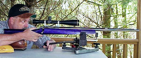

Joel behind the 6×44 Borden, with a 27″ Kreiger. Joel earned most of his 2004 SOY points with this 13.5-pound gun.

During competition I try to send five bullets down range on my record target as fast as possible under the same conditions (which usually last just a few seconds). At St. Louis they timed a couple of my strings at 9 seconds (per string), but normally it takes me 15 to 20 seconds, maybe a little faster with the BAT gun since it has an ejector. Once I get started it is almost impossible for me to stop and take a second look at the Hensley flags or mirage. I just grip it and rip it and hope for the best. I cannot see the bullet holes at 600 yards. I can tell when I have shot a good target–everything is working correctly (table manners), and the gun just slides right back on target. When I shoot the best I never have to touch the joy-stick on the Farley from the first shot to the last. When I’m shooting well, I just get into this mental zone, what I call my “A Game”. There are no secrets, no “Fairy Dust”. It takes good eyes, a well-tuned rifle, and a lot of luck. 95% of the matches involve some luck of the draw. Interestingly, all last year I did not shoot in the first relay except for the St. Louis match, and there I set three world records. (The photo at right shows one of my record-setting targets.)
