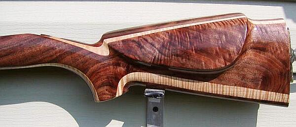

Richard’s rifle features a BAT Machines SV (short) RBRP action with fluted bolt, a Holland recoil lug, and a BAT +20 MOA Weaver-style scope base. Richard prefers the short action for stiffness, but this requires pulling the bolt to remove a loaded round. The stock is Richard’s Model 010 in a three-layer laminate–outer layers of fancy walnut with a 5/8″ center strip of curly maple. The stock is bedded with Richard’s own stainless pillars (with escutchens). These pillars, one of Richard’s “signature” features, are hand-made from barrel stock provided by a prominent barrel-maker. The 010 stock has a wide, stable beavertail that extends just rear of the recoil lug area for added strength in that area. The straight comb is as high as it can be made and still be able to insert a bore guide. With some actions a cut has to be made in the top forward part of the comb to allow the bolt to fully open. (Richard’s Model 007 has a similar design, but with a shorter beavertail, and a roll-over comb–see photos at bottom of page). The stock has quite a bit of drop from the grip to the toe. Richard tells us, “this is important for the varminter who shoots from bipod and improvised rests. The drop makes it much easier to adjust elevation with your rear bag.” The barrel is a 27″ Krieger 14-twist, with six lands and grooves. A BAT trigger guard and Jewell trigger round out the component list.

Richard tells us, “A good bedding job is as critical to accuracy as the best barrel money can buy.” For a pillar-bedded rifle, Richard begins by turning stainless pillars from sections of cast-off barrels. It takes him half an hour to make a single pair of 1/2″-diameter pillars with a 7/8″ bottom flange or “escutchen” (see forward pillar base in photo). He mounts the pillars in the stock with Devcon, then relieves wood from the stock interior to provide fill space for a Devcon coating under the entire action. His pillar-bedding work is exceptional–the man really knows his stuff. A two-bolt installation costs $140, while a three-bolt job is $20 more. Costing $40 per set, the stainless pillars are only available to customers who purchase his stocks.
Richard offers a variety of finishes, but for this rifle he used a hand-rubbed oil finish over 10 coats of clear. After applying the clear-coat, he spent about three hours rubbing the finish with #0000 steel wool. This dulls down the shiny gloss. Then came the labor of love. He applied WATCO Danish oil liberally to the stock with his fingers, removing the excess with paper towels. Rubbing out with the towels smooths and polishes the wood. The end result is a handsome satin finish that looks like a classic all-oil finish, but is much more durable since the undercoat is epoxy clear. Richard tells us: “It takes a lot of time, but the end result is worth it–you end up with a beautiful finish that is much tougher than oil alone.”

Richard Franklin is one of the few men in America who sells strong, beautiful stocks laminated from fancy hardwoods. To accomplish this, Richard had to be an engineer as much as a woodworker. He designed his own stock duplicator as well as a gluing press that uses three twenty-ton hydraulic rams. This allows him to laminate hardwoods with no visible gluing seams. Richard explains: “Glue lines can ruin a beautiful stock”. Richard is modest about his operation, but he really is doing something unique. His technology allows a customer to enjoy the beauty and elegance of presentation-grade hardwoods, with the stability and stiffness of laminated wood.
Conventional laminated stocks are made from multiple layers of dyed Birch hardwood which is very dense. This can make an exceptionally strong stock. They are available in many combinations of colors, some really nice and some really wild, but they all have a distinctive utilitarian look as compared to Richard’s laminates made from fine woods such as straight-grained Walnut, Curly Walnut, Curly Maple, Osage, Wild Cherry, and Brazilian Cherry. Richard tells us: “For the 10.5-pound BR rifle I have found that the Eastern Red Cedar is about the only wood that will make weight in my model BR2000 stock.” Richard’s hardwood laminates can mimic a classic one-piece stock. While he normally uses 5- or 7-layer laminates, when he has a really spectacular piece of wood Richard uses a 3-part laminate, with the left and right sections cut from a single block: “When I do anything out of real fancy wood, we want all the finely-figured wood to show on the outside, so we’ll use three laminates. Three laminates makes it much stiffer than a conventional one-piece stock, but it will look like a one-piece stock, with perfectly matched sides. A three-layer stock will never warp or move, and it will shoot as good as 10 layers. When working with the best blanks, you have to get a happy medium between number of lams and the beauty of the stock.”
Richard employs a variety of fine woods, Walnut (Claro, Bastogne, English), Cherry, Curly Maple, Birdseye Maple, and Cedar to name a few. For his premium stocks, he’s always looking for a superior piece of wood. He acquires a lot of his blanks from Northwest Timber in Washington state, but now and then he’ll go out and fell a tree. He tells us: “it takes a huge amount of time and effort to cut your own wood. I’ll usually only do this if I can find an original growth tree with a thick trunk and lots of crotch and burl in the base. Walnut Burl is rare. It’s hard to find one that is long enough to make a gunstock. When I fall a Walnut or Cherry tree I buck it into four-foot logs and then haul them home to be immediately sawn on a bandmill into blanks usually measuring about 4″ X 10″ X 40″. These will be air-dried for about two years and then taken to a local kiln which will further reduce the moisture content to about 8%. The best figure in the butt area comes from a blank that is cut from deep into the stump. This requires a lot of work and causes many dull blades and chainsaw chains. The next best figure comes from a crotch-cut blank (two intersecting limbs) of sufficient size. You want no heartwood or sapwood in your blanks. With Curly Maple, the most desireable figure displays numerous, smaller stripes in the wood that are very consistent the full length of the blank.”
Richard is a strong advocate of wood stocks for performance as well as aesthetics: “Wood is much easier on the eyes. It feels better in your hands and shoots better than a hard, rigid glass stock. I would never own a glass stock for a match rifle. I believe most rigs will shoot better in laminated wood. Fiberglass can be just as brittle as a pane of glass. Fiberglass can transfer vibrations back into the barrel, so the gun hums like a tuning fork. Wood is more dense than fiberglass so a wooden stock dampens vibration better. The only reason I’d want a synthetic stock would be for elk- or bear-hunting in the mountains, where durability is your main concern. For that, I’d want something like an HS Precision.
Yes I know many records have been set with fiberglass stocks, but I think that will change with our improved designs and wood lamination technologies. Terry Leonard and others are producing superb wood stocks and more benchrest shooters are going to wood now. With more nice wood benchrest stocks available, you’ll see more matches being won with wood. Certainly in the 1000-yard benchrest game, more and more top competitors are demanding wood these days.” For more information, contact:
