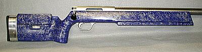

Among the Hoovers’ eight guns, some have wood stocks, and some are fiberglass. John’s laminated gun is an earlier stock design with a low-profile fore-end and adjustable cheekpiece, while Dianne’s new silver gun uses the latest version of the “Master 1000” stock with a distinctive “step-down” fore-end and a fixed comb. Other than stock variations and the right vs. left action configurations, all the Hoovers’ rifles are built as identical as possible. They were all chambered with the same Henriksen reamer. In fact, John tells us that the chambers are so uniform that ammo can be interchanged between the guns, though normally brass is segregated by rifle.
Wood vs. Glass–What Works Best?
John tells us: “We mostly shoot wood stocks because we were shooting long before the glass Master 1000 entered production. As far as ‘feel’, if we were blindfolded, we could tell the difference mainly because the early wood stocks are about 2 3/4″ wide while the new Fiberglass version is 2.90″ wide. Concerning vibration, I personally don’t feel any difference. Some people may. The wife says she doesn’t feel any difference. She shot both glass and wood last week and didn’t sense any difference. When it comes to performance in extreme temperatures, I’ve never seen any differences between the glass and the wood versions. I attribute that to the way Alex Sitman inlets the barrel channel. He takes care to make sure the stocks are sealed properly. I’ve seen glass stocks at Williamsport that just have the barrel channel routed out–they are not sealed properly. That can cause problems.

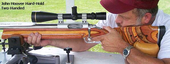

Q: Could you explain the “Hoover” style of gun handling for us? Have you ever tried free recoil?
Everyone in the family grips the stock. We all hold on pretty good. Not because the gun jumps out of your hands. We’ve just learned you have to control the rifle and you do that by getting a good grip on the rifle. None of us shoot free recoil. We use a fairly solid cheek weld. I use a “two-hand hold”. Since I’m a lefty, my right hand holds the front of the stock by the front rest. I do all my elevation adjustment with my shoulder.
When we start shooting, after the first couple of sighters, our heads never leave the stocks. We’re constantly watching through the scope with a constant head position and cheek weld. I think that’s important. If someone moves his head all the time–what’s the chance his head to stock alignment will be the same for every shot? He may get it close, but not as close as if he puts his cheek there and leaves it there.

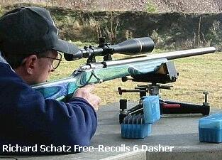

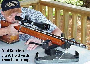

Just as every rifle is unique in its load requirements and bedding preferences, one must also hold the rifle the way it likes to be held. You can shoot free recoil, hold hard, or anywhere in between. The Hoovers have a fairly distinctive two-handed shooting style that has proved extremely sucessful for them. But as John Hoover says “this style works great for us, but many great shooters use a different method. You need to try different styles to see the hold best suited to you and your particular rifle.” Basically I see four ways to hold a rifle riding sandbags, but each can be modified to suit your situation.
Thumb Pressure (TP): In this case, shoulder position is the same as free recoil, but you apply light, consistent pressure with your firing hand thumb. This helps tame a little more recoil energy than shooting FR. Hard-Hold One-Handed (HH1): Here you have firm contact with the entire shooting hand, and shoulder. Most long-range BR competitors shoot this way. It allows bag-squeezers to reach around and adjust the rear bag with their off hand. This hold will lessen felt recoil more than FR and TP. Hard-Hold Two-Handed (HH2): I don’t think this exists in short range BR, but several successful shooters in long-range BR use this method. This is the same as HH1, with the addition of hanging your non-firing hand on the fore-end. Due to the amount of contact with the stock, this style is undoubtedly the most difficult to do consistently.

Free Recoil (FR): finger on trigger only with little or no pressure from your shoulder on the buttstock. The rifle moves on its own, with guidance from the bags until your shoulder resists it enough to stop rearward movement.
The best way I have found to discover your optimal hold for maximum precision is to set up a target at several hundred yards (my test was at 400) with several aiming points oriented vertically. This is done so you can dial the front rest up to the next point and fire another group as fast as possible.
