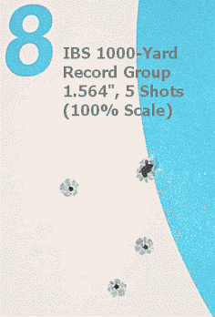

The 2002 season started off with me shooting this rifle in both light and heavy gun classes. My basic load was similar to that which the Crones were using: 53 grains of H4831 powder and either Federal or CCI primers and Hornady 140gr A-Max bullets. At the start of the season a shooter from Tennessee by the name of Greg Sigmund showed up. Greg had just started producing his .625 BC, 147gr “Clinch River” VLD bullets. I purchased a few hundred and started working with them. On August 17, 2002, I was rewarded with a 1.564″ five-shot IBS-record Light Gun group. As I recall from my notes, the weather conditions were average for that time of the year. It was sunny with some breezes and luck was on my side. On that particular day, we shot Heavy Gun first and I got called into the scoring shed because they could only find 9 out of 10 shots on the paper. The group was in the upper portion of the target and it was possible that I lost one over the top. Later that afternoon, someone came out from the scoring shed and said they needed me again. Uh-Oh! As I walked in, I could see the target and what appeared to be just four shots in a small group–that had me worried. But as I got closer, I could then see there was a double and everyone around the table started congratulating me on a new possible record. That’s the story of this record. It was something special. Prior to this group, the rifle was shooting in the five to seven inch range which is pretty much where most decent guns shoot.

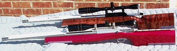

How do my two guns compare in terms of accuracy and general performance? First of all, the record-setting red gun has been relegated to 600-yard matches. I rebarreled it for a 6mm wildcat that I developed utilizing two reamers. I combined a 6mm BR reamer to give the base dimension and then ran my .243 Ackley reamer in .300″ short. The result is a 6 x 44 Ackley or, as I call it, a “644 Super”. It is throated for the 100-grain class VLD bullets. Capacity is 44.5 grains of water. The 6mm barrel currently on the red gun is an 8.5-twist cut-rifled Border barrel. This tube is still fairly new and is showing some good results. At Piedmont recently, the red “644 Super” had a new potential 600-yard record going with four of five shots. But sadly, one dropped out at 6 o’clock to make a sub .9″ group into a 2.5″ group–yep, that one hurt. Overall, I can say that both guns are shooting well and they seem to work with my shooting style. I shoot both rifles with very little grip or hand pressure. But I wouldn’t say I use free recoil technique. Both these guns kick more than your PPCs, so you need a little hold. Normally, I am almost in contact with my shoulder and I rest my trigger hand on the Edgewood Gator bag and just use my finger to “touch the trigger”.

Of the two rifles featured in this article, the red gun set the 1000-yard record when chambered in 6.5 Super. (I subsequently rebarreled it to a 6mm for 600 yards, and I use the wood gun for 1000 yards). The red stock is a fiberglass Shehane Tracker. It has a piece of 3/8″ re-bar running from the tip of the fore-end down to the action. The barrel channel was milled out; the bar set below the channel surface and filled with epoxy resin and fiberglass matting. Lead shot and epoxy resin were also poured into a hole drilled in the butt for weight. The action was an original CPS-SLV (Central Products for Shooters) provided by Walter Pirera, Central Products’ owner, after he sold the business. (It is now Time Precision in Connecticut.) This action still needed some minor machine work to adapt it to my 6.5 Super cartridge. The SLV stands for “Steel, Light Varmint” and was primarily used for the PPC cartridge. It was more or less an improved clone of the XP-100 using 18 TPI threads with a longer tenon. I adapted the action for the larger rim size, and fitted a Jewell 1.5 oz. trigger.
When shooting 6.5 Super, the red gun was fitted with a 28″, 8.5-twist Krieger in Heavy Varmint contour, tipped with a Brownell’s muzzle brake. To allow sufficient elevation for 1000 yards, I had Art Cocchia, the proprietor of Time Precision, make me up a 20-MOA elevated base to hold the Leupold 24X fixed-power target scope with 1/8th-MOA dot reticle. I did all the paintwork as my trade background was in auto body painting and fiberglass work (e.g. Corvettes).

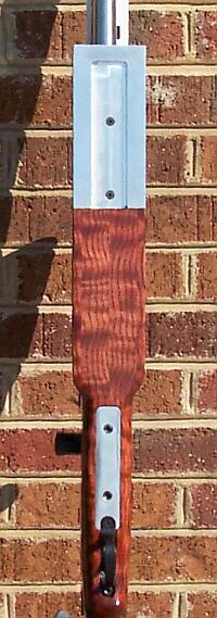

My new 6.5 Super is built on a four-part lamination of Curly Ash crafted by one of our Hawk’s Ridge club members. He has a stock duplicator and he shaped the stock along the lines of a Tooley MBR stock. The bottom of the butt from the toe to the grip was reshaped to run parallel to the fore-end and the lower edge was narrowed to 1/2″ to better fit my Edgewood Gator bag. Again, as with the red rifle, I milled the barrel channel from the tip of the fore-end to a point directly in front of the Jewel trigger. In the channel, I inlaid a piece of 1″ x 3/8″ aluminum flat stock. The Viper right bolt, right port action sits on top of it. Under this piece of aluminum, I glued two short pillars. On the underside of the stock, forward of the trigger guard, is another piece of aluminum that contacts those pillars. They are drilled and counter-bored for the socket head screws, which hold the action. Lead shot has also been added to the butt for weight.
On the underside of the wood fore-end, I fitted a piece of 1/4″ aluminum plate with the center milled out to form two tracks. This piece was glued and screwed into the reinforcing aluminum under the barrel channel. A 8.5-twist Krieger barrel, identical to the one originally on the red record rifle, was chambered with the same 6.5 Super reamer and fitted to the Viper. (Krieger donated this barrel after I set the record.) One of Lynwood Harrell’s muzzle brakes was then installed. Stiller provided me with 20-MOA rings to hold another Leupold/Tucker 24X scope. The Curly Ash stock was stained “red oak” and then covered with over twenty coats of clear lacquer. I sanded in-between every three coats to eliminate any “cavities” in the finish. The end result is smooth as glass!

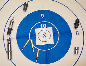

In developing my loads, I started with the H4831 recipe Bob Crone was using for his 6.5 Super. Yes, I tweaked powder charges and seating depths and tried various primers but really didn’t do anything earth-shattering. The record group was shot using Norma brass, which was on its eighth reloading. One somewhat unconventional thing I do is to anneal my cases after EVERY firing. Charles Bailey, the 2000 IBS 1000-yard Shooter of the Year, suggested I do this. The purpose of regular annealing is to insure the necks give the same grip every time. Also, I believe it is very important to keep the necks brushed out and clean. I soak my cases in CLR (calcium, lime and rust remover) for two hours after annealing. Then I brush out, rinse and dry. Charges are trickled onto a RCBS 10-10 scale utilizing a fixed magnifying glass to read the scale. My current match load is 53.5 grains of H4831sc behind a 147 Clinch River bullet with Fed 210M primers. (NOTE: this load may be too hot for a standard 6.5-284 case.) I turn my case necks to .012″ wall thickness. Using a .284″ neck bushing, this gives me a .288″ loaded round for a .290″ chamber. This means I have less neck clearance and tighter neck tension than some other shooters prefer, but it works for me. I seat the Clinch Rivers to just engrave the rifling on the ogive. All my dies are pretty much custom-made. For my shoulder bump/neck-sizing die, I ran my chamber finish reamer into a blank from Bald Eagle Precision. Similarly, I created the seater from a blank Wilson hand die cut with the finish reamer. For any base-sizing that needs to be done, I use a modified Redding .284 Win body die. (I hogged out most of the guts except for a small ring at the base). My basic reloading advice is pretty straightforward. Develop a technique that gives you consistent ammunition. I like to keep my case weight consistent to within 1.5 grains. Primer pockets are uniformed and flash holes chamfered on the inside. Necks are turned to within .0001″ to .0002″. I don’t recommend “fitted” necks in the long-range game. I allow .001″ on either side on the neck or .002″ total clearance. My PPCs had only .0006″ total clearance. Start annealing your necks once the cases are fully fire-formed (i.e. after two to three reloadings). Polish or brush the inside of necks every time. The more even the pull on the bullet, the lower your Extreme Spread. The lower the ES, the less vertical you get. Cartridges should enter the chamber easily so that when the bolt handle closes, you just feel slight resistance (zero headspace) and extraction should be unobstructed. If you have to bang the bolt handle to get it open, you will upset the gun in the bags which costs you time and rhythm. Of course a good action is important too. When it comes to smooth extraction, the more modern Stiller Viper definitely out-performs the older CPS. |
