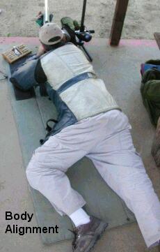

General Prone Position–American-Style vs. Euro-style
Parker: German, most members of the U.S. Palma Team use a long, low position with the hand stop far forward and the body mostly inline with the rifle. This position is not as widespread among European shooters. So which method is best? What does your position look like and feel like?
Salazar: Scott, positions are talked about a great deal–perhaps more than they merit. But nonetheless they deserve our attention as a good position is truly the foundation of successful prone shooting. Building a position is a circular exercise because it depends on proper rifle adjustments but those adjustments, in turn, depend on the position. I suspect most of us sneak up on the ideal position over a long period of experimentation and adjustment.
My position has evolved over many years of prone shooting (since 1971) and is fairly low. In fact, upon the imposition of a 30° arm rule in Smallbore, I had to make an adjustment in my position to be sure I complied. I prefer not to compare my position to that of other shooters in a hypothetical sense, but there are some specific points I look for.
1. Stability: Let’s face it, if the position isn’t stable, then it isn’t worth pursuing. Prone is an inherently stable position because of the large amount of body contact with the ground as well as the low center of gravity. However, with a bit of attention to detail, a shooter can build a “more stable” prone position. A useful test of stability is to remove the trigger hand from the rifle while on aim–the rifle should not move at all. I do this as a natural point of aim check on each shot.
2. Durability: Once a string of fire starts, it’s going to take an act of Congress to get me to remove the rifle from my shoulder. The simple reason is that I want to fire my 22 shots from one position, not 22 positions. Therefore, the position has to be durable. Proper butt-plate and sling adjustments will keep the rifle firmly in the shoulder (without pain or discomfort) and proper comb height adjustments will keep your neck from straining. Ideally, your cheek should never leave the comb during the string.
3. Comfort: I hesitate to include this element because it is often misunderstood, but here goes. Comfort does not mean you are in a recliner watching TV; it means you can get through 22 (or more) shots without pain. Your arm shouldn’t fall asleep, your fingers shouldn’t tingle, and your neck shouldn’t hurt. If you don’t have that degree of comfort you won’t have the durability we described earlier. Finding this comfort level is largely a function of rifle and sling adjustments.

Body Height–How Low Should You Go?
Parker: I started prone shooting with a low position. It worked well for me until I went to a Highpower clinic put on by a Marine. He put me into a high position, shortened up my length of pull and moved my hand stop closer to me. I shot well that way also. However, it seems that I have reached a plateau. This high position transmits a lateral pulse beat that is at least 1/2 minute. This can be seen on my short range targets clearly, as the groups are always twice as wide as they are tall. I will be revisiting the long and low position soon. David Kimes, former 300m world record holder, told me that the majority of World Cup shooters have their butt to hand stop length equal to twice the length of pull. This is in good agreement with your assessment.
I think it is difficult to workout all the muscle tension in the support arm in the high position. The natural tendency is for the support arm to be leveraged outboard by the sling tension. If one’s natural point of aim does not allow for this, muscle exertion by the support arm will be used to correct the aim. Nine times out of ten, the shot will land out at 2:00. Do you consciously avoid using your muscles in position?
Salazar: I agree that a very high position is really not a long-term solution. It can be helpful when trying to teach someone at the beginning phase as it ensures that the shooter is not holding the rifle with his muscles or “falling into” the rifle, but it is also very fatiguing and, as you mentioned, not the most stable way to shoot.
My position doesn’t rely on muscle tension to support the rifle in any way. You asked if I consciously avoid using muscle tension. I have to say no. There isn’t a conscious effort to eliminate muscle tension because there isn’t any and if it creeps in–say from an oddly sloped firing point–it is immediately recognizable and I adjust the sling to eliminate it.
My sling is fairly low on the arm and my first checkpoint when getting into position is to push it down as far as the retaining strap on the coat allows. This ensures that it’s right where I want it and that it won’t creep down during a string. The next step is to push my forehand hard into the handstop to eliminate any slack between the web of the hand and the handstop. I have found that if I don’t do this the first shot or two will recoil (and impact) differently. In Smallbore that’s a small inconvenience but in Highpower, where you are often limited to two sighters, it can be a disaster.
