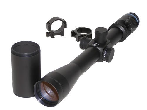

The biggest problem I have with my IOR scope is the rear rubber cover on the zoom control (power ring). I am not going to yank and pull on it to see if it will come off, but IOR’s engineers certainly could have devised a better way to secure this to the power ring. Note, the blue fitting shown in the photo has been replaced by a black metal ring. The weight of the scope, 28 ounces, is a noticeable 6 ounces heavier than the Leupold 8-25 LRT, but still much lighter than the big Nightforce NXS scopes. The MOA markings and number adjustments could be larger and more visible then they are currently. I like the Nightforce and Leupold turret markings a bit better. The scope’s elevation and windage are unknown to me and I have heard that it packs nowhere near as much as Nikon or Leupold. [Editor’s Note: IOR lists windage and elevation adjustments of 65 MOA, compared to 72 moa for the Leupold LRTs.]
