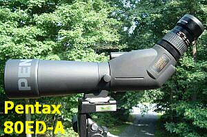

#3 The Pentax PF 80ED-A with 20-60 zoom. For the money the Pentax is an excellent scope, fully waterproof, with ED glass, and the ability to adjust the angle of the eyepiece–very handy when sitting at the bench or shooting from the ground. This combination was not quite as good as the other two. But, at half the cost, the PF 80ED was definitely a contender. I noted that Better View Desired (BVD), a respected optics review, has chosen the Pentax PF-80ED as its “Reference Standard” among 80mm-class spotting scopes. BVD declared that Pentax offers “simply the finest eyepieces currently available for any scope on the market.”
At this point, I must say that none of the three could resolve 6mm bullet holes at 500 and beyond 100% of the time, especially when the mirage was running at its worst.
I chose the Pentax 80ED as my next scope purely on the basis of pricing. Both the Zeiss and the Swarovski nearly twice as much as the Pentax. The Pentax, mounted on my 3221WN tripod with the 3047 head, proved to be a good performer that allowed me to see bullet holes about 50% of the time at 500 and beyond when conditions were bad, and 100% of the time when conditions were good.

PF-80ED-A 80mm 19′ to Infin 56.4 oz. 19.4 oz. 19″ 22-18mm
PF-100ED 100mm 28′ to Infin 91.7 oz. 19.4 oz. 24″ 22-18mm
The PF 80ED was considerably less massive, so I mounted in on my lighter 3221 tripod. The big 3251 tripod was the logical choice for the heavier and longer 100ED.
