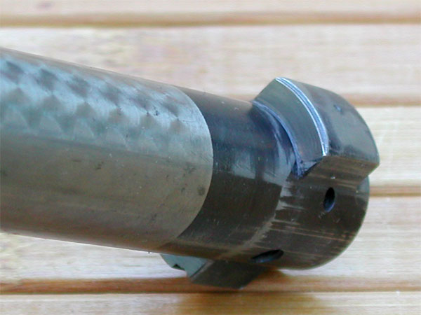

Like any piece of machinery subjected to high pressure and cyclical movement, the bolt needs lubrication. There are three main areas on a typical bolt that need lube: the locking lugs, the cocking cam, and the extraction cam.
1. The Rear Surface of the Locking Lugs
There are two lugs on most bolts, three or four lugs on some actions. Wipe these clean with a paper towel before re-applying the lube. Dab a little of the grease on the tip of the small screwdriver and spread it on the lugs. This should be a thin, even coat. Just thick enough to cover the metal but not globbed on. This picture shows the lugs wiped clean before lubing. A locking lug recess cleaning tool such as Sinclair Int’l offers is useful to ensure that any grit and bits of brass that collect in the receiver’s lug recesses get cleaned out.
