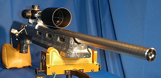

It’s big news when Lapua decides to make brass for a new cartridge. That cartridge is the 6.5mm Grendel. Derived in concept from the 6PPC, the Grendel offers excellent long-range performance in a format that can feed reliably from an AR-compatible magazine. This week we premier this interesting new cartridge in a full-race bolt-action rifle, built by SG&Y Precision for Grendel pioneer Arne Brennan. It features a special Stolle action in Speedy’s handsome new Robertson Composites F-Class stock.
The First-Ever Turnkey F-Class Rifle
Arne’s gun is one of the first examples of the new Speedy/Robertson F-Class rifle, a turnkey solution that’s “race-ready” out of the box. All the components are optimized for long-range “belly benchrest” competition. The gun features an 8-32×56 Nightforce NXS in Kelbly rings, a Stolle RBLP Panda ‘F-Class’ action, and a 28″ Kreiger 1:8.5 Palma-contour barrel with SG&Y’s distinctive “Spider Web” finish. The rifle has some very unique features. Stolle’s new action boasts an integral recoil lug that simplifies barrel changes. A tapered 20 MOA scope rail is milled directly into the receiver so you don’t need “add-ons” to reach 1000 yards with most scopes. The slick Robertson adjustable cheek-piece uses magnets to allow the whole unit to detach quickly for cleaning.
Arne gives this report: “Overall, the fit and finish of the Speedy F-Class rifle is excellent. The Robertson stock is comfortable to shoot and rides the bags smoothly. The magnetic mount holds the cheek-piece securely, but you can set the adjuster wheel so the whole unit pops right off for easier cleaning or bolt removal. The rifle tracks perfectly and recoil is minimal–I’ve allowed a couple of people to shoot it and the consistent comment is ‘put the crosshair where you want the shot and that is where the shot goes.’ Some of my fellow AR15 shooters say this rifle is so accurate that any small ‘driver’s error’ in technique or aim is immediately apparent.”

At first glance, the SG&Y F-Class stock looks like an MBR Tooley design. MBRs are sold by Lone Wolf, McMillan, and Bruce Baer among others. But close examination will reveal subtle but significant differences in the grip, receiver area, flats and angles. The underside of the fore-end is seamless, for example, and the side-flats are perfectly parallel. The internal construction is far more sophisticated than most fiberglass stocks built from ordinary cloth, resin, and foam. ![]() Builder Ian Robertson explains: “Our stocks are built with epoxies formulated to give the best structural characteristics with a variety of reinforcing materials. A close watch on the ratio of resin to reinforcing materials is required to achieve the best strength to weight performance. All our stocks are post-cured at elevated temps to stay stiff and strong in hot weather or cold. The action area is composed of a solid composition to give a solid and stable base to the bedding. The fore-end is filled with a light weight material (not foam) which provides excellent stiffness without adding non-structural weight. Butts are solid-filled in target styles to allow the installation of cheek piece adjusters. All of our stocks use carbon fiber in critical areas to add stiffness at low weight. We have CAD, CNC and digitizing facilities. All our inlets are done CNC and many of our stocks have been produced with the aid of this technology. The SG&Y ‘F-Class’ model was produced completely with this technology and has many details which are hard to see in the photographs but are revealed in the CAD illustrations.”

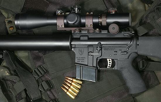

The 6.5 Grendel was originally conceived for the AR15 platform. The idea was to have a cartridge that performed better at long-range than the .223 Remington, while still retaining the ability to feed multiple rounds from a magazine. AR15 National Match and cross-course shooters had turned to the long 80-90 grain VLD bullets in pursuit of better long-range ballistics. However, this required that the rounds be single-fed because the OAL (with VLDs) exceeded mag length. I wanted a cartridge that would mag-feed as well as the .223 Remington. In addition, I wanted a cartridge that would be good for hunting whitetail deer, feral hogs and other game.
While .223-chambered AR15s shooting VLDs performed well out to 600 yards and beyond, this was not an ideal solution. Given a choice of platform, top cross-course competitors favored other cartridges such as the 6mm BR Norma, 6mmXC, and .260 Remington in rifles such as the Tubb 2000, “Tube Guns” or the Armalite AR10. I wanted to develop a better round that would still work with the AR15 platform.
I looked to the PPC family of cases for the answer, since the PPC is considered the most accurate case design ever invented. The 22 PPC would drive the 80gr bullets needed for 600 yards in a mag-friendly length. However, I didn’t feel the 22 PPC using 80gr bullets would provide the competitive edge I was seeking nor would it perform well for hunting. In contrast to the 22 PPC, the 6PPC was able to do both jobs (competition and hunting) by using 105gr Bergers or 107gr SMKs for competition and 85-100 grain Nosler Partitions for hunting. But one thing still bothered me about the 6PPC. The 2.255″ max mag length meant I had to seat the 105-107 grain bullets way back in the case, or I had to modify the mags. Notching magazines had zero appeal so before going further with the 6 PPC, I decided to think “out of the box”.
I knew that Sierra made a 6.5mm 107gr Match King and Lapua made a 6.5mm 108gr Scenar. Given their larger diameter, these bullets were actually shorter than their 6mm counterparts. So, I could use these 6.5mm bullets without seating bullets back in the case or notching magazines. Then, I found that Lapua’s 123gr 6.5mm Scenar matched the BC of Sierra’s 107gr 6mm MatchKing yet it was no longer than the 108gr Scenar! Bingo–by moving up to 6.5mm, I could equal 6PPC ballistics with a 107gr Sierra without modifying mags or seating the bullet too deep in the case. In addition, 6.5mm was a proven game caliber with many good 100-125gr controlled expansion hunting bullets available.

high-quality Lapua brass AND factory-loaded ammo. Optimized for the AR platform, 6.5 Grendel ammunition from Alexander Arms operates at a safe and sane 49,000 psi. Using the excellent 123gr Lapua Scenar bullet (.542 BC), the loaded ammo will run 2670 fps from a 26″ barrel, and will feed reliably from a magazine. Custom 10- and 17-round 6.5 Grendel AR magazines are available for $27.00 from CompetitionShootingSports.com.
Current factory loaded cartridges are shown in the photo. Left to right: 129gr Hornady SST, 123gr Lapua Scenar, 120gr Nosler Ballistic Tip. Ballistics for Alexander Arms’ factory-loaded ammo have not yet been released. However, I’ve produced a detailed ballistics chart for the 6.5 Grendel with 108gr, 123gr and 144gr bullets. It includes the .223 Rem, 6.8 SPC and 7.62×51 NATO (.308) for comparison. Click to download .pdf format Ballistics Chart.
