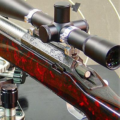

When Texas gunsmith Speedy Gonzalez set out to build the “ultimate PPC” for his own use, he wanted it to be as handsome as it was accurate. Here is his latest creation, a real stunner that combines some very trick components with old-world detailing. When was the last time you saw an engraved receiver on a “race gun”? This rig combines the best of both worlds–modern high-tech componentry with classic good looks.
Speedy’s latest competition 6PPC features a one-of-a-kind engraved Stiller Viper action, with integral scope rail, SAKO Extractor and non-fluted bolt. The action sits in a new Millenium BR-X carbon-fiber stock built by Robertson Composites. The bold red-on-black marbled finish is how the gelcoat comes from Ian Robertson’s factory–the stock has not been painted. The slick front rest is a titanium Ultra-Rest machined by John Loh with design input by Speedy. John built only two of these in titanium, one for himself and one for Speedy. The regular steel version runs about $725 including front pad. The Leupold Competition scope sits in quad-screw bedded rings from S.G.& Y. Precision Rifles. Speedy picked a very special barrel for this project–a 1:14 twist, 20.5″, 6-groove barrel, the last original Pat McMillan-crafted barrel in Speedy’s inventory. Speedy runs a .263″ neck. Bushing size depends on the load and the condition of his brass. Speedy’s match load is about 29.2 grains of the IMR 8208 “ThunderBird” powder (he stockpiled this great propellant years ago). Speedy feels that T-Bird may be the most user-friendly BR powder ever made: “Once you have a good load worked up with T-Bird, you can shoot it at most any location in the country, and in almost any conditions. It’s not fussy about temperatures or humidity.”
A Very Unique Viper Action, Two Years in the Making
This is no ordinary Viper action. The full engraving attracts your attention, but there are some slick “performance mods” Jerry Stiller added at Speedy’s request. First, the action features a plain-Jane unfluted bolt, with a slight taper in the middle, a bit of a wasp-waist. Speedy prefers an unfluted design because it has superior wear characteristics. He’s found, when working with an aluminum action such as the Viper, the sharp flutes on the bolt will wear the inside of the action faster. In the interest of reduced wear, he also requested a smaller-sized loading/ejection port. This provides for a larger front and rear receiver ring. With more receiver metal front and rear, the bolt bearing surface is enhanced. More bearing surface reduces point loading which, in turn, should result in less internal wear. We were surprised that Speedy did not order a drop port for his Viper. He explained: “I’m a bag squeezer, so I keep my forearm right where the cases would exit the drop port. I’ve used the drop ports, but given my shooting style, I prefer a conventional port.” Speedy did decide to fit the bolt with a SAKO-style extractor. He believes this is easier to tune and can contribute to accuracy. Speedy told us: “With a conventional sliding plate extractor, like you find on the Stolle actions, there can be a bit of a side push as you chamber the round. I think this can affect the way the bullet enters the chamber. With the SAKO extractor there is no side-push so I can reduce the possibility of bullet misalignment. Yes you can tune a conventional extractor to lessen the side-push, but it takes a whole lot more work to get it right.”
