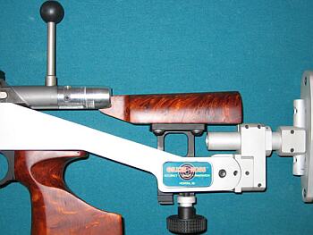

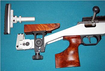

While Mike has detailed his rifle, I’d like to add a few words about the Ross Precision stock and its use as part of a system. The Ross stock is completely unique in that it will accept just about any barreled action you can think of. Centerfire actions will need to have the barrel shank contoured to a 1.00″ straight section for the first 5 inches, smallbore actions, which typically have a straight taper barrel under 1.00″, can be accommodated with a pair of machined shims.
Apart from the barrel clamping mechanism that allows multi-action use, the most innovative feature of the Ross stock is the butt assembly. No other stock allows as much adjustment in terms of both range of motion and type of motion. Once fitted to your body and position needs, the Ross stock feels like it grew there. If one approaches the adjustments with the idea of seeking the perfect fit and carefully analyzing the contact points, pressure points, sight/eye alignment, eye relief, balance, etc., judicious use of the range of adjustment will serve you well. ![]() Profile: German Salazar is a noted 300m shooter and a founder of ShootersJournal.com. |
