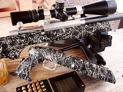

BAT 7.5″ Action–With a Few Extras
After speaking to several of the shooting world’s “Top Guns”, I decided that I could not go wrong with BAT in terms of quality and precision. Plus BAT could customize the action to my specs. I called Bruce Thom and he told me he could build what I wanted, a six-sided Multi-Flat (7.5″x1.5″) with flat bottom, integral scope base, and two bolts. An undercut on the bottom of the action serves as a recoil lug. The scope rail is machined into the action like on a Kelby Panda, but of course it is stainless not aluminum. Two sets of Kelbly rings on two scopes top it off with a Jewell trigger set at 16 ounces.
The action is a work of art, and the custom features perform just as I had hoped. BAT milled the integral rail in such a way that the scope ring bases do not bind or mark the rail when installed. Chalk that up to some Bruce Thom wizardry. To swap optics, I simply loosen the rings’ rail cross-bolts and carefully slide one scope off and replace it with the other scope with its own pair of Kelbly rings already attached. The rings tighten up solid with nearly no change in zero. When I change to my Nightforce from my Zeiss 6X scope I only need to dial in about 0.5″ of vertical at 100 yards. And there is no horizontal shift when I switch scopes. Amazing! That tells me the difference in scope height explains the small shift in POI. It goes to show you how precise this action and rings are machined.
I also had Bruce make me two bolts for this action–one diamond fluted and one spiral fluted. The action and both bolts were bead blasted to match the Kelbly rings’ finish. The workmanship on this action is truly remarkable. You have to cycle it to fully appreciate the quality. The bolt feels like it is sliding on glass. The tolerances are extremely close and there is absolutely no slop. There are many good custom actions out there and I have several and sold a few others that I have used. To me, this is the finest precision action I have seen or owned. BAT actions are not cheap, but you get what you pay for.
Twin Stocks for Twice the Fun
Pistol Stock: I started with a Bruno’s solid-filled benchrest stock. I wanted the stock to balance in the center of the scope area so the gun would not tilt forward. I removed material from the fore-end (and reshaped it slightly) until it balanced with the fitted barrels. The gun balances well off the bags when firing off the bench and also off my pack when I am in prone or sitting in the field. The stock feels nice and stable and, being solid fiberglass, vibrations and torque are minimal. Tommy Meredith did the pillar bedding and I did the paint. It still has a little torque when fired off the bags with a loose hold, but I think that’s because of the short fore-end. In the field, with a tighter grip, it feels right and besides, that is why I made it this way. My “Jackal” pistol is really compact when slung on my shoulder. I can even stow it in my backpack when I have a long trek to an area where I’ll hunt. (Very sweet.)
Rifle Stock: I had an SG&Y coffin-style benchrest fiberglass stock that was lying around for a while. I did not want to ruin it by cutting it up at the front or back, so I called Wenig Custom Stocks and asked them to duplicate Speedy’s stock in birch laminate. It came back identical, but being wood rather than glass, I could easily modify the front and rear of the stock using simple tools. I then had Bruce at BAT Machine inlet it for my action. From there, I sent my action and the stock to Tommy Meredith to pillar bed. As I did with the pistol stock, I took off material from the front and back to balance with barreled action attached. Then I did the sanding and paint work.
