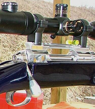

When Gerry Nordmann emailed us a photo of “Badlands” it was hard to believe this was a Savage. Plain Jane it’s not. Gerry explained: “I’m a fan of Savage actions, and I see no reason why they can’t perform at a very high level with the right components, assembled by a good smith. I commissioned Fred Moreo of SharpShooter Supply to build this rifle. He supplied the bare single-shot action and everything else from recoil pad to muzzle brake. The stock is Fred’s Long-Range Benchrest model, (Tooley style), glass-bedded by Fred, and painted by Zac Ingram. The highly-polished action secures a 27″ 1:8″ twist Douglas barrel tipped with a medium diameter SSS muzzle brake. ‘Badlands’ is chambered in 6.5-284 with a no-turn .297” neck. The action has been fully trued and re-timed, with a reverse baffle washer and a SSS Benchrest Trigger set at 12 ounces. Other features are a competition heavy recoil lug, and an oversize tear-drop bolt handle. A NightForce 12-42×56 BR scope (B2 reticle) rides in Burris Signature Zee rings on top of a +20 MOA Farrell base.

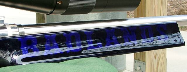

A Paint Job Evoking the Wild West
Call it extravagant, but I wanted this rifle to look really special. The paint job ended up costing more than the action, by quite a bit. But Zac Ingram did a spectacular job, and I really enjoyed working with him on the stock design. I wanted something with: A) The Badlands; B) The Old West; and C) The Sturgis Motorcycle feeling. You’ll notice a buffalo skull on the rear of the stock. Native Americans believe a buffalo skull brings luck (which any shooter needs), and decorated buffalo skulls are popular South Dakota folk art. The Badlands, which I found very interesting, are shown in the moonlight, painted in the dark candy colors that are popular on custom motorcycles. And, the lettering on the fore-end was done with an Old West-style font. The paintwork took over two and a half months because of Zac’s other work and an injury he suffered.

Setting up for 1000-yard Shooting I knew I would have to “pre-load” quite a bit of up elevation into the rig to be able to zero at 1000. The Burris Signature Zee Rings worked out very well. With the Farrell 20 MOA base already on the rifle the Burris ring inserts allowed me to add another 10 MOA, to give me a total of 30 MOA. In addition, I can use the inserts to cancel out the 20 MOA in the base if I want to shoot under 500 yards. After getting trajectory data from the free JBM site, I was able to go to local club with a 100-yard range to sight in the rifle for 1,000 yards. I took a four-foot piece of cardboard and marked an aim point at the bottom, then measured up 30″ to where the bullet strike should be at 100 yards if zeroed for 1,000 yards, and marked my point of impact (POI). Within five shots I had the rifle sighted in for 1,000. And, as it turned out, my first Iowa 1,000-yard sighter shots were within six feet of the clay birds used for sighting in. At 1K it’s very difficult to find your POI, unless you can kick up some dust and be able to see it in the small field of view you have with your scope. So I was glad I’d worked this out ahead of time. |
