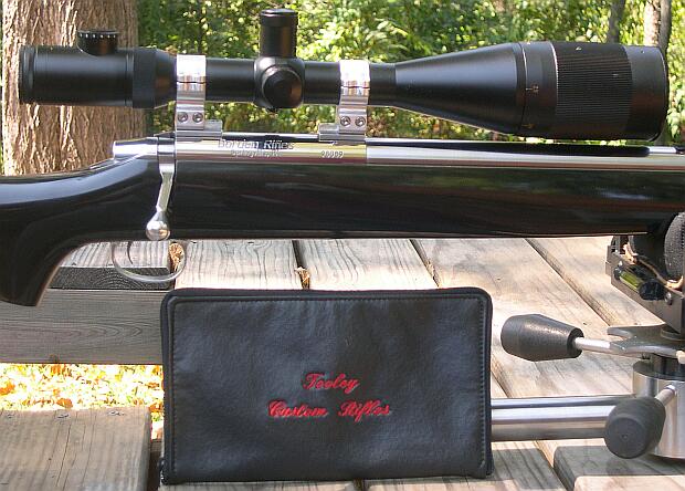

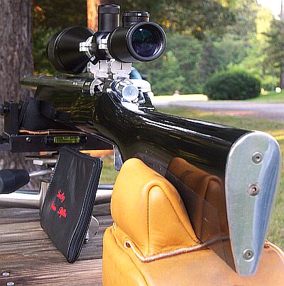

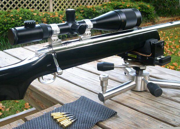

The record gun was originally built by Jim Borden as a 6PPC with a Hart 20.5″ barrel. The action is an early Left Port, Right Bolt “TPE Borden” glued into a black Borden glass BR stock. Terry noted: “With one of my other rifles, I tried a 6×44 similar to the cartridge Joel Kendrick shoots. That shot decent, but not spectacular, and I soon decided that 6×44 case-forming was WAY too much work. So, I took the black rifle to Dave Tooley, and he put on an 8.5-Twist, 28″ Krieger 4-groove, chambered in 6mm BR Norma with a .267″ neck. The barrel is a Heavy Varmint taper about .94″ at the muzzle. With the 28″ tube, the rig was nose-heavy, so I added a two-pound plug of solid lead in the rear. Even without a brake, recoil is mild. With a little thumb pressure on the stock, I can see impact on target, and I can even follow the vapor trail when it’s humid.
The scope is a 12-42X Nightforce Benchrest model with a varminter style reticle. At some point I plan to change to a simpler target dot reticle. The aluminum rings are from Speedy (S.G.& Y.) and they’re really nice. The front rest is a custom unit made by Jeff Ferguson, with a Bald Eagle windage top with ribbed front cordura bag. My current rear bag is leather Protektor with rabbit ears. I used to use the lower ‘bunny ear’ model, but Wolf suggested I try the taller ears. I did and I think the taller ears stabilize the gun better. On the leather bag I use some graphite to slick it up, while I use silicon on the cordura.”

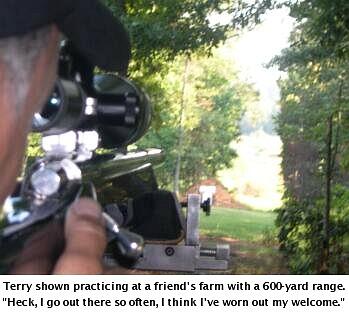

Q: Any Advice for New Shooters? A: Get good equipment. Find a good gunsmith. Pick a caliber with low recoil–that will get you back on the target quickly. Do a lot of practicing, and always shoot with windflags if possible. I’m lucky because I’ve got a buddy with a 600-yard range on his farm. I go practice there all the time. In fact, I’ve probably just about worn out my welcome there. I work in a cardboard container place and on a white piece of cardboard you can see the bullet holes easy at 600 yards. |

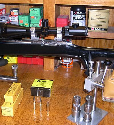

Terry notes: “My record match load was 31.0 grains of Vihtavuori N540, with CCI 450 primers. I actually got this load from 6mmBR.com. The 600-yard competition page listed N540 as the favorite powder of Larry Isenhour, another Piedmont 6BR shooter. I did experiment with a number of powders: Varget, IMR 4895, N540, Reloader 15. The gun liked all the powders, but N540 produced the smallest groups. Second best was Varget, running about 2950 fps. I haven’t chron’d the N540 load in a while but I think it’s around 2900 fps.
I use Berger 105gr VLDs, with factory moly coating (it’s just a mess if you coat them yourself). I started measuring the first 105s I bought, and they were very consistent so I quit measuring them, but I only have a couple boxes of the good bullets left. These are early California production, from a few years back, purchased from a local store. I hope the new ones are just as good. My seating depth is about .010″ off ‘max jam’. I figure that’s about .015-.020″ into the lands. Cartridge OAL is 2.383″; this has the shank (bearing surface) filling about 60% of the neck. [Editor’s note: Dave Tooley used a separate throating reamer to cut the chamber, matching a dummy round. He estimates the freebore is about .120-.130″.] As far as neck tension goes–I use a .263″ Wilson bushing on a neck that’s .266 with bullet in place.”
Reloading Procedures–Keeping It Simple
Terry doesn’t employ any exotic reloading methods: “I weight-sort the brass to start with, then I very lightly uniform the primer pockets. I also uniform the flash-holes, but just enough to catch any burrs. Sinclair makes a good deburrer that doesn’t oversize the flash-holes. Since my rifle has a .267″ neck, I turn the cases to about .0115″ neck-wall thickness for a .266” loaded round. This is a simple, one-pass operation. I understand the appeal of a no-turn chamber, but I don’t think I would go to a no-turn neck in the future. It’s just not a big deal to turn the cases when I’m relaxing or watching TV. I use a K&M neck turner with the carbide mandrel with doughnut cutter. This is a great tool, but you have to be careful when inserting the mandrel or you can score the necks on the inside. I use regular 3 in 1 Oil on the mandrel and I put a little grease on the cutter tip. I use a tooth brush to take the shavings off. After turning, I’ll chamfer the neck mouths inside and out. I fire-form with a normal load and a bullet in place–usually during practice sessions.
I throw powder with an RCBS measure to 28-29 grains, then trickle up manually and weigh each charge with an RCBS 10-10 scale. Bullets are seated with a standard 6BR Wilson hand seater. After the rounds are fired I do a lot less work than many shooters. I don’t tumble my brass. I just clean up the outside of the necks with “Never Dull”, then I’ll clean the inside of the necks with a nylon brush chucked in an electric screwdriver. I DON’T normally full-length size the cases. I simply neck-size using a Wilson bushing die. In fact, my 6BR match brass has NEVER been full-length sized after it was fire-formed. The brass that shot the record had six or seven firings on it, and the primer pockets are still good and tight.
I may have to full-length size pretty soon, and I have a Redding body die for that. But for now, neck-sizing only is working fine. As for trimming, every four or five firings I’ll find the shortest case and trim them all to the same length. Most of the time they’re within a couple thousandths–around 1.553″. I don’t anneal my cases–either during the case-prep process or after shooting the cases. I can see how annealing could help extend brass life, but again, it’s extra work that doesn’t seem necessary yet.

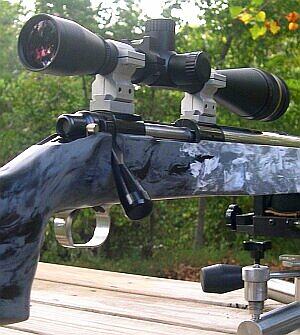

Currently, Terry shoots his 15.5-pound 6BR in IBS “Heavy Gun” class, though it only weighs 15.5 pounds. He does this because HG rules prohibit muzzle brakes, and his “big boomers” have brakes. For Light Gun class, where muzzle brakes are allowed, Terry shoots his 17-pound 6.5-284. Smithed by Leonard Baity, the 6.5-284 features a blue-printed Rem 700 action (with Jewell trigger) pillar-bedded in a Shehane Fiberglass MBR Tracker stock. Next season Terry may replace the muzzle brake with a fitted cap so he can shoot the 6.5-284 in Heavy Gun. Terry gives high marks to the MBR-style stock: “Most 6.5-284 shooters like to grip the stock a bit, to handle the recoil. The MBR Tooley, with its high comb and comfortable grip, gives me the option to use a little cheek weld and use some hand pressure. From my experience with my hunting guns, I’m accustomed to using some cheek contact and gripping the gun. The MBR lets you do that if you want. The stock also tracks great. The 6BR doesn’t recoil as much as the 6.5-284, but if I was building a new 600-yard 6BR from scratch, I might just go with an MBR stock. I like how they shoot, and I think it would balance better with a 28″ barrel than some of the ultra-low-profile short-range benchrest stocks. You can still shoot an MBR free recoil if you like, or just use a little thumb pressure, which is how I shoot the black record gun.” In his 6.5-284, Terry uses H4350 powder (with Fed 210M primers) to push 140gr Berger VLD bullets through the 30″ 8-Twist Krieger barrel. The scope is an older, fixed-power Leupold 36x with front-mounted adjustable objective. Terry observed: “It’s a fine scope. Maybe Leupold should have stuck with the old 36x model. They seem to be more reliable than the side-focus models”.
