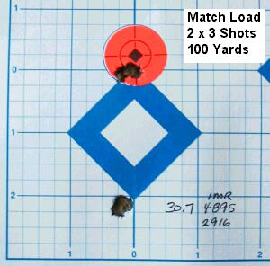

The most remarkable thing about this gun, compared to its previous incarnation as a factory .260 Rem, is consistency. The second and third rounds through the gun went through the same hole during fire-forming at 50 yards. No matter what I feed it, it groups from the high Ones (for three) to the low Threes (for five), and the groups are almost always tight clusters. It has shot great with Varget, IMR 4895, and Norma 203B, from 2720 fps to some charges topping 3000 fps (the 3K loads were very accurate, but ES was high and the brass took a beating). I normally load .015-.022″ into the lands, but the few times I tried jumping the bullets .012″ it shot equally well. I can’t really say what load is the most accurate, because it has become obvious that “driver” skill is really the key factor in group size. My rangemaster, a much better shooter than I, sat down behind the gun and ripped off a .165″ three-shot group at 100 yards in gusty winds. His first two shots went through the same hole and he felt he caught a little wind on the third. That was with a load of 30.5gr Varget.
When the gun was a .260 Rem, I could get some very good groups with 100gr Sierra Varmint bullets, but the heavier 140gr class bullets (SMKs, Scenars, Amax) more typically grouped about .6-.7″ and split groups were the rule. I’d get three or four shots tight, and the fifth would inevitably be out a half an inch. As a 6BR, this gun just doesn’t give flyers. It also proves that the people who say the long 6mm bullets can’t group at 100 yards are just wrong.
Since the purpose of the gun is to shoot 600-yard Varmint Silhouette matches at the Ojai Gun Club, which has some very challenging winds, I wanted a load that would push a high-BC bullet pretty fast. I was hoping to achieve 2950 fps with good brass life. Well, I reached that velocity, but it was not healthy for the brass. I think I’ll settle for something in the 2890-2910 fps range. All three powders (Varget, IMR 4895, and Norma 203B) will deliver this. Initially, I’ll probably be using the 4895 in matches as it seems a little more consistent with velocities in the 2900 range than Varget, and it is readily available, unlike Norma 203B.

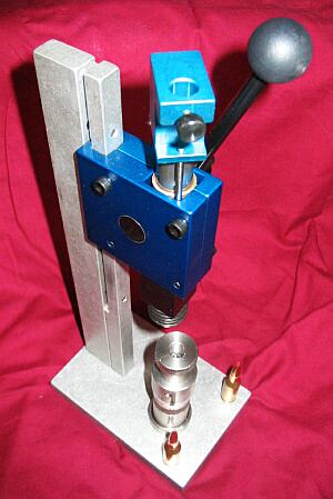

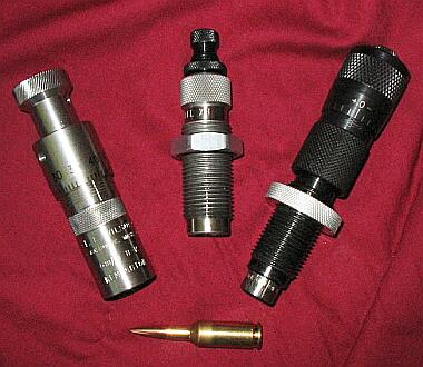

To achieve the kind of results shown in the targets above, you need very good components (Lapua brass and bullets), and high-quality tools. I use dies from three different makers. Most of the time I seat bullets with a stainless Wilson Micrometer seater die. This is one truly superior piece of equipment, worth every penny. When I rotate the bezel one index mark I get exactly .001″ change in seating depth. The Wilson is machined like a Swiss watch, and it fits Lapua brass perfectly. I can’t praise it highly enough; it is smooth, precise, and simple to use.
When a threaded seating die is appropriate, I use a Forster Ultra-Micrometer Seater. I wish the markings were a little easier to read, but other than that, I’m 100% satisfied with the die. The sliding sleeve fits a 6BR case perfectly (with less play than on my Redding Comp Seater Dies for other calibers). The micrometer top moves smoothly, and, like the Wilson Seater, the index marks correspond precisely to changes in seating depth.
Is the K&M press perfect? Well, not quite. To adjust the ram height, you have to loosen four Allen-head bolts. A simple quick-release handle (as found on the Sinclair and Harrell’s arbor presses) would be better. But once you’ve set the height for your dies, that’s really not much of an inconvenience. The other thing I noticed is that the K&M, with its spring-loaded ram, could use more leverage when seating cases with a lot of neck tension. I noted that when seating bullets into fresh Lapua brass taken right out of the box, I really had to mash down on the handle to get bullets to seat. For this reason I now slightly expand the necks of Lapua brass for the initial load, or I use the Forster seater in an RCBS turret press. |

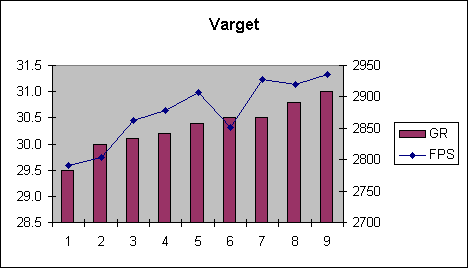

For fire-forming I started with 29.5gr Varget, then bumped that up to an even 30.0gr to get a little better case formation. Bullets were the 105gr Scenars, loaded hard (.020″) into the lands to give a good crush fit. I then worked up a ladder with Varget, and accuracy held all the way past 2940 fps, but my brass was taking a beating at the top end. The CCI 450 primers handled the higher pressures fine, but at the high end I did see some loosening of primer pockets.
Frankly, I could have stopped at a charge of 30.5 Varget. That was a good, reliable load that produced excellent velocities with the lowest ES and SD I’ve yet recorded. In once-fired brass with the factory-spec small flash holes, 30.5 grains was very accurate, with ES of 7 and SD of 4.0. But, like most reloaders, I had to tinker with a good thing so I then used a K&M PPC flash-hole deburring tool to uniform the flash holes. That was a mistake I think. The tool reams the .059″ diameter flash holes to about .067″-.069″. Lapua uses a special precision process to form the flash holes, and the flash hole diameters are very consistent. I think it is very difficult to ream them and achieve a consistency level equal to the factory flash hole. Moreover, increasing the flash hole diameter seems to have increased ES and SD. From now on, I will leave the flash holes just the way they are.

I’ve been working on a review of QuickLOAD reloading software. In considering various alternatives to Varget, I noted that QuickLOAD predicted that both IMR 4895 (not the H4895) and Norma 203B should provide greater max velocities than Varget. Both IMR 4895 and Norma 203B also can achieve near 100% load density in the standard 6mm BR case. Though Varget had shown excellent accuracy, I wanted to see if IMR 4895 and Norma 203B would really deliver more speed. Reader John Adams was kind enough to donate two cans of the hard-to-find 203B, and I had some IMR 4895 in my powder stock already.
Of the three powders I tried, Varget probably has a slight accuracy edge, but IMR 4895 and Norma 203B are not far behind. If the 203B was readily available I might concentrate on that because it does appear it can push the 105s a bit faster than Varget, without beating up the cases too much. And it is very accurate at the high end. But right now, nobody stocks Norma powders, so I’ll be focusing on the other two powders. I did a lot of testing with IMR 4895 in the last two weeks. It looks promising, it meters a little easier than Varget, and it looks like it will deliver 2900+ with very good accuracy. Speeds up to 2930 fps might be possible. Unfortunately my chronograph had fits with the last set of loads I tried so I can’t confirm that. The Shooting Chrony doesn’t like bright sun directly overhead. I’ve gotten the most consistent results on hazy days, with no sun-shields. Yes, there is an Oehler on my wish list. For the upcoming match I’ll probably be loading 30.7 grains of IMR 4895, jammed into the lands (but a little less than before, .010″ or so–that seems to produce a lower ES). The ES and SD are still higher than I like, but I attribute that to the fact that my current set of brass has been worked very hard. With new Lapua brass, ES was very good during fire-forming.
These charts are provided for comparison purposes only. Do NOT use the data as recommended loads in your rifle. We deliberately “pushed the envelope” to see how much the brass could take. The higher listed loads are, in some cases, far in excess of powder manufacturers’ max loads.
Be sensible, be safe. With all the powders, we recommend you start at under 30 grains with Lapua 105gr bullets. Work up to 30.5 grains or so in 0.2 grain increments. As you approach max pressure things get dicey fast. With the cases running at 100% load density, we saw a mere 0.1 grain load increase result in up to 20 fps added velocity, with accompanying higher pressures. Also note that very slight variations in seating depth can make a huge difference in pressure.

With the hot loads I’ve been testing, I full-length size my brass each time. I couldn’t afford a true custom die, so I called Redding and ordered their standard full-length (non-bushing) die–with a twist. Redding reamed the neck to provide .002 tension for unturned Lapua 6BR brass. Redding did a fantastic job. I now decap and size the brass in one easy step, with no bushings to mess with. I had problems with doughnuts in other guns when using bushing dies. I have a theory that bushings contribute to doughnut formation because they push brass down into the neck-shoulder junction. Well, it looks like that theory may be right. With six loads on some of my 6BR brass there is absolutely no sign of a doughnut.
The pride of my reloading bench is my K&M Arbor Press. This unit employs a unique toggle-link that provides ultra-smooth movement of the ram during bullet-seating. In addition, the bottom of the ram features a Bellville Washer stack, which acts as a spring that compresses during the seating stroke. This provides extra feedback during the seating process, and the spring compression can be monitored with an optional strain gauge that fits in the top. When you add the gauge to the unit you get a visual read-out of bullet seating effort. We’ve found empirically that when bullet seating force varies significantly from round to round, your ES jumps and accuracy falters. Using the K&M Arbor with the optional gauge lets you monitor seating force and thereby load more accurate ammo. It really works, and I’m completely sold on K&M’s technology–at least for cases with light to moderate neck tension.
