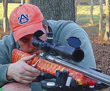

Harold tells us: “I built the rifle for long-range varmint hunting and the Hickory Groundhog Shoot. The rifle shoots in the 0.2s at 100 yards, even with the long VLD bullets. And I’ve logged many groups well under one inch at 500 yards. The secret is that the rifle is very consistent. It doesn’t generate those strange flyers you often see with VLD bullets. I also credit much of the gun’s accuracy to the 32x Leupold Mark IV scope (boosted from the original 16x by Premier Reticles). You may notice the tape around the elevation turret. It has marks that correspond to my 100, 300, and 500-yard zeros. The elevation has not changed at those yardages in five shooting seasons including a trip out west for a prarie dog hunt. Now that’s consistency! For the Hickory Shoot you not only have to shoot small groups but they must group exactly where you are aiming because it is basically bulls-eye competition with no sighters.

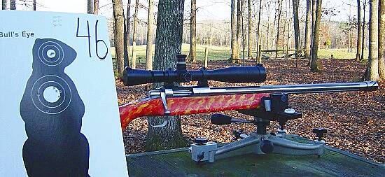

The rifle features a Hall “B” action holding a 1.250″-diameter straight-contour, fluted Spencer barrel finished at 27″, with a big honkin’ brake. The chamber’s a standard 6mm BR Norma with a .262″ neck. I turn my case-necks to about .261″ and use a .257 neck bushing for lots of tension. The action is pillar-bedded in a McMillan benchrest stock. Clay Spencer did all the smithing including the stock work. Built as a dedicated “Egg Shoot” gun, the rifle weighs 27 pounds, very heavy for a 6BR. But my philosophy is if the rules don’t limit your weight, build the gun heavy for stability. With a muzzle brake the recoil is mild to say the least. After you break the shot, the gun simply slides back an inch or so, with zero hop or roll. That makes the gun an absolute delight to shoot. I’ve been asked about the oversized diameter muzzle brake. It’s not there for barrel tuning although Clay and I have speculated that it might be doing some good in that regard. No, the large diameter makes the brake more effective at recoil reduction and reducing muzzle turbulence.

Granted the rifle is heavy but I believe it shoots so well because of the “controlled” recoil. When Clay built the rifle he took great pains to balance the rifle properly through bedding, component selection, and weight distribution. Clay calls this “recoil balancing” and it requires the use of two scales and some pretty sophisticated engineering. One of the “secret components” on my rifle is a very heavy half-inch thick stainless butt-plate. This balances the front and rear of the rifle. As a result, this gun is exceptionally stable on the bags and the motion during recoil is completely linear–it comes straight back, no rock ‘n roll. I never need to adjust the rifle after pushing it back into battery! When you pull the trigger the rifle just goes poof that’s it! It still recoils about an inch but there’s no lateral or vertical motion. I’m not sure how to explain it, but almost all other rifles I’ve shot seem to erupt and jump when you shoot them. Not this gun.

It goes without saying, the Hickory is a very difficult match, patterned after actual ground hog hunting. You need a very accurate rifle and very good shooting skills. Above is my 2004 match-winning target. The top cluster was shot at 100 yards. The 300-yard 3-shot group in the central bulls-eye (all in the white dot) measures .878″. That’s the kind of accuracy it takes to win. Not only must you shoot very small groups but your shots must impact exactly where you aim them. Those who have shot the Hickory in past years should note that some of the rules for this year’s shoot have changed. The most important change is that no mechanical rests are allowed–so bring your bipod or Uncle Bud’s sandbags. Also, first-time Hickory shooters are not eligible for the Grand Prize. The 2005 Rules are printed below and you can also get more info from Larry Willis of Bulls Eye Sporting Goods.
